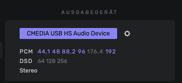

My Upsampling table - r8brain used
44.1 → 44.1
48 – 48
88.2 → 88.2
96 → 96
176.4 → 88.2 … or to 192 better?
192 → 192
352.8 → 88.2 … or to 192 better?
384 → 192
Which algorithm is better r8brain or SoX? Whats the difference? Measurable, audible?

I think it don’t means upsampling - it just makes Audirvana output 1:1 bit perfect at those sampling rates. Maybe an Audirvana developer is reading this? →
44.1 → 44.1
48 – 48
88.2 → 88.2
96 → 96
192 → 192
My basic question is whether additional upsampling is useful, because the Wolfson DAC probably does that internally too.
These exceptions are necessary because the DAC cannot handle these sampling rates, which I found out by trying a 176.4 test music file. →
176.4 → 88.2
352.8 → 88.2
384 → 192

What does Adirvana with the DAC cannot sampling rates?
Which I found out by trying a 176.4 test music file. →
176.4 → 88.2
352.8 → 88.2
384 → 192
I test this some times ago - I had to run this test again.
The only restriction I made max 24 bit
Adirvana knows about the DAC could work
DAC
Now everything is switched to 1:1 bit perfect!
Audirvana turns the 24-bit MQA track 352.8 kHz (i.e. 1,211 kbps) into → DAC: 24/88.2
With DSD from DSD64 (i.e. 5.644 kbps) to → DAC: 32/88.2 kHz
With a noise test file 16 bit 176.4 kHz to → DAC: 32/192 kHz
Sometimes 32 bit although the DAC supposedly only supports 24 bit. I would have to read the data sheets of C-MEDIA CM6631 USB-to-S/PDIF receiver (24bit/192kHz), WOLFSON WM8804 S/PDIF receiver, WOLFSON WM8741 D/A converter-chip, especially what they do with bit widths higher than 24 bits.
The last of these tests was several months ago and I still had the Audirvana version from January … March - now the Audirvana Studio 2.1.0 (20100) macOS 13.0.1 with 16GB physical RAM is installed.
