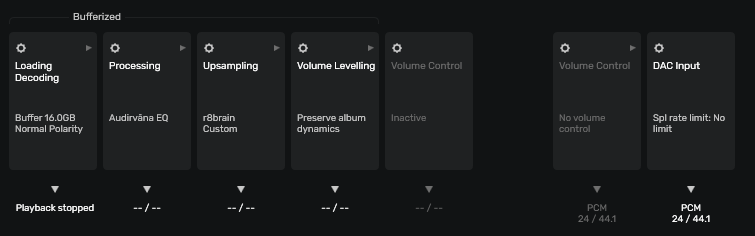

Screenshot 1: Audirvana correctly detects 24-bit capability

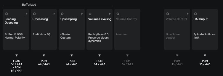

Screenshot 2: Audirvana dithering down to 16-bit from 64-bit

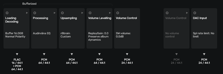

Screenshot 3: Enabling software volume control results in 24-bit output
