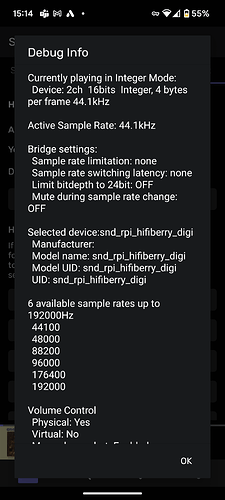

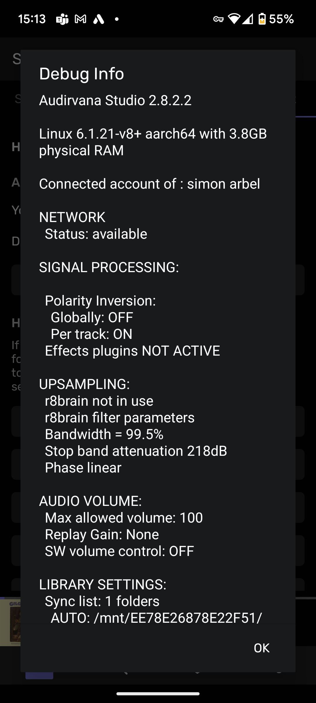

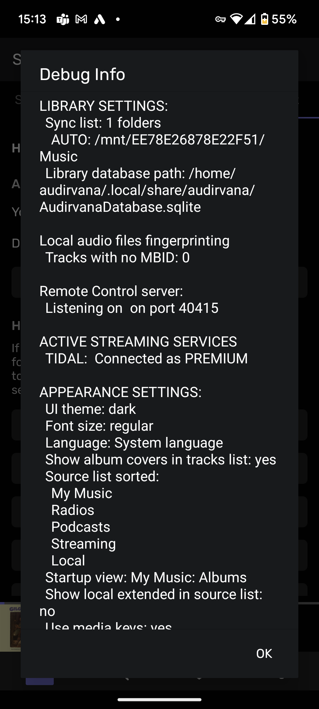

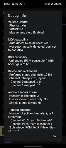

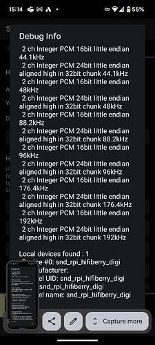

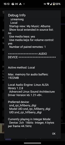

Attaching screenshots
Last one
Ok, you mention issue playing TIDAL HD, can you please describe more what is going on?
There is noise coming out instead of music. It’s basically the same noise resulting from a poor handshake via I2S between the DAC (Denafrips Pontus II) and the Raspberry Pi 4 I2S HAT (Ian Canada TransportPi Digi).
