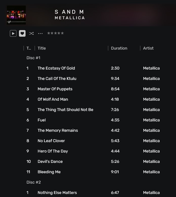

Within the album browser, you’ll only see one album:
…but individual discs and their tracks within that album…

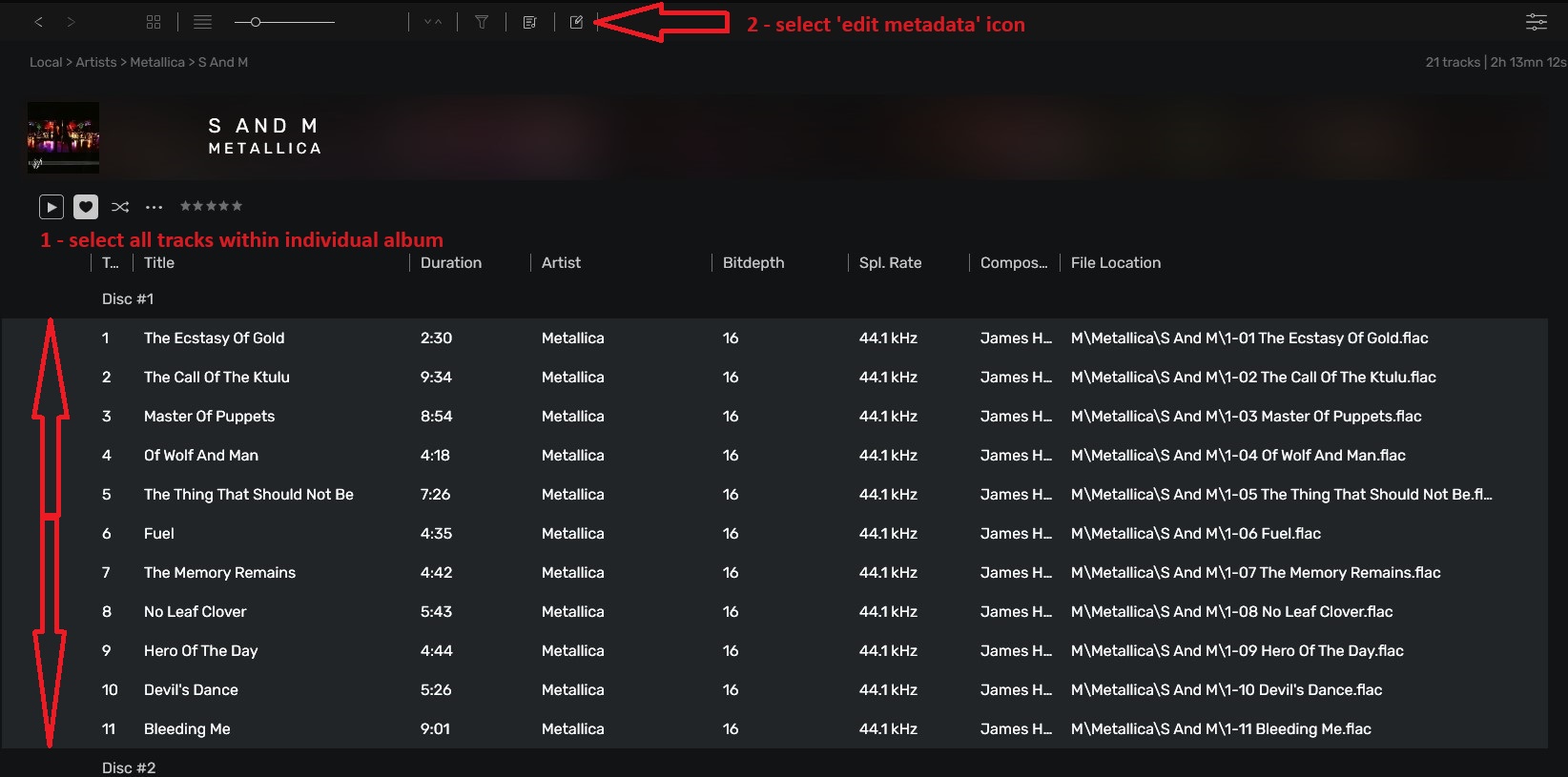

Whilst I don’t use this method myself, you can also select all the tracks within an individual album and amend the disc no metadata from within Audirvana:

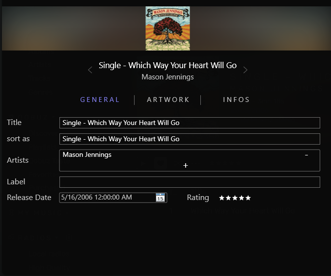

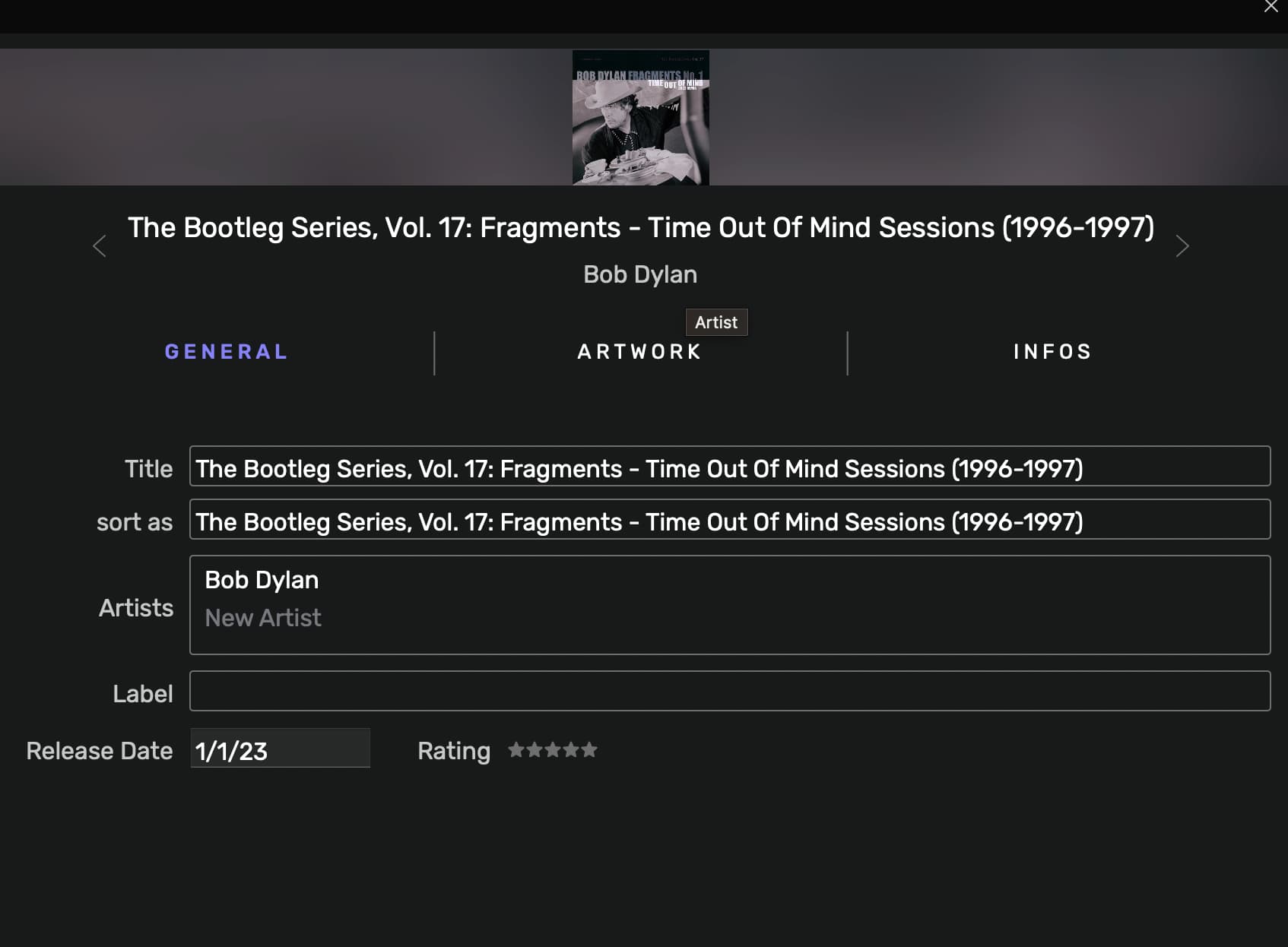

This is all I have when I click on my Metadata. I tried to rename the lines as you can see to 1/5 and so on. Didn’t help.

Your window shown here is went you click an album… album metadata
in that album when you see the tracks, you will have many metadata to edit…
just select one song or select all songs to them having the same metadata

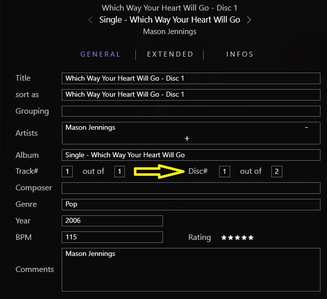

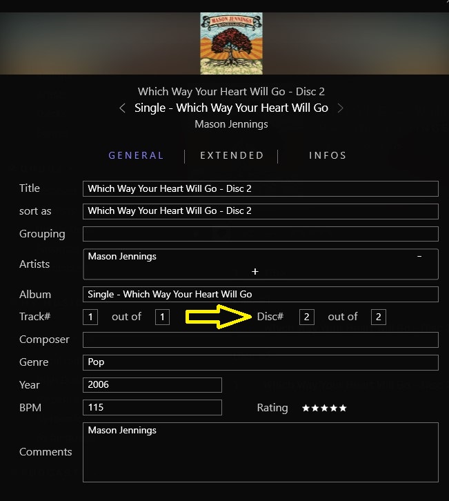

Interestingly I looked at a single track in my library, which also appears to have no disc no info associated with it when viewed in Audirvana Studio…
…however when viewed in my metadata editor (dBpoweramp) the relevant info is there …
1
It would appear that you do actually need to add the amount of discs within the boxset/multi-disc release via an external metadata editor, with Audirvana not being able to do so (perhaps another user on here could clarify this???).

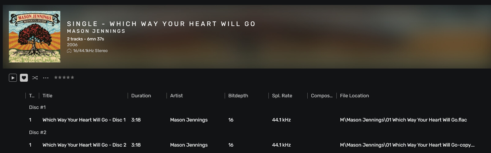

As a test, I copied a single track, but gave it the same album title as the original whilst amending the disc no.
This resulted in Audirvana displaying 2 tracks, 1 album, and 2 disc no’s (pretty much what you want to achieve, I believe).

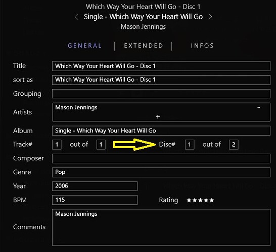

If you only have a single disc (1/1) , the disc no info doesn’t appear to be displayed within Audirvana.

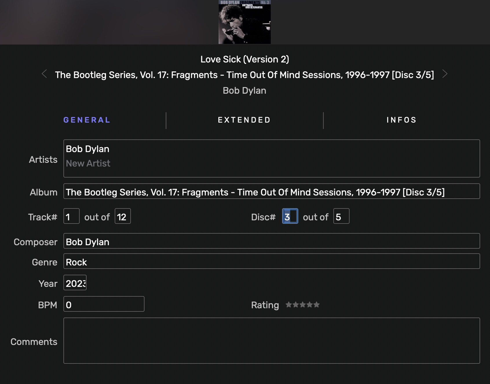

This is from just one track. It shows what you’re saying to a degree.

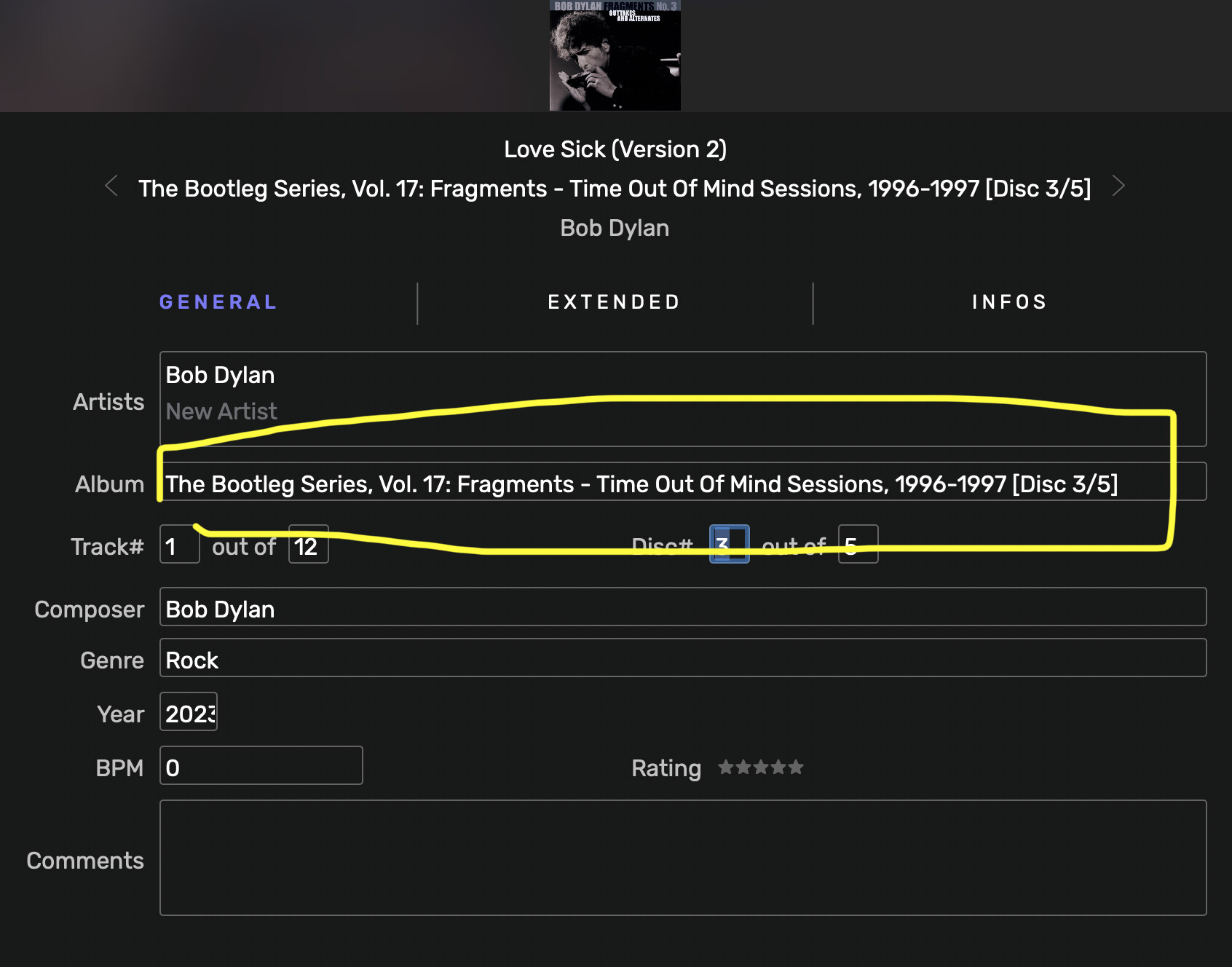

I assume that the album title should be identical across the 5 CDs. That the [Disc 1/5] should not be there, otherwise they are 5 different albums.

Yep, although tagging the album within a boxset (Disc3/5, in your example) would surely result in these individually named albums appearing as seperate albums within Audirvana?
A boxset of 5 albums should, in my opinion, all have the same album title (without the disc number within the title), with each album contained within given their own disc no?

In the Metadata that I had in Audirvana the Album name with [Disk 2/5] for instance and then the next album was [Disk 3/5] It was messing it up to give me separate albums.
I went with you guys continuing to drill in my head same Album name and that did it. I got rid of the Brackets and disk Numbers.
