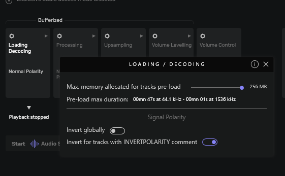

Hi.
Since audirevana didn’t detect my system memory, I couldn’t configure the preloaded memory. How do I solve this?This seems to be causing problems when I play upsampling music.
Thanks!

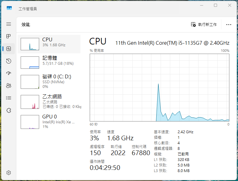

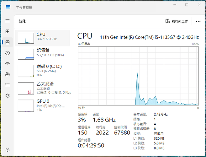

How much memory does Windows itself report? (Look in Windows task manager/performance/memory).
Do you have problems with other programs not recognizing RAM in Windows too?
Thanks for your reply!
There’s 32gb, I have no problem with other programs.

Why Audirvana thinks you have a windows 11 system with 0gb of memory?? that is why it put the lowest memory buffer size… 256mb and can’t be moving forward.
