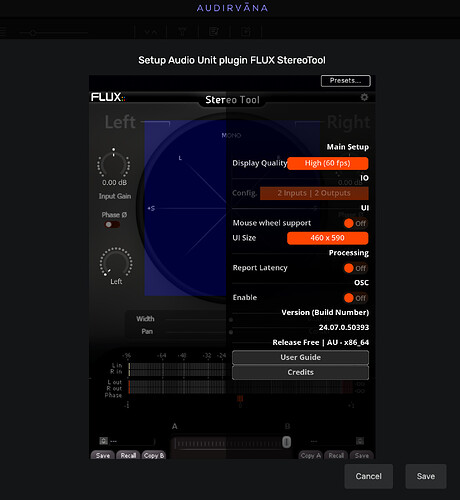

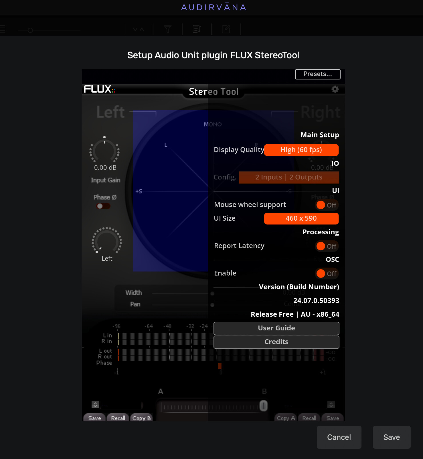

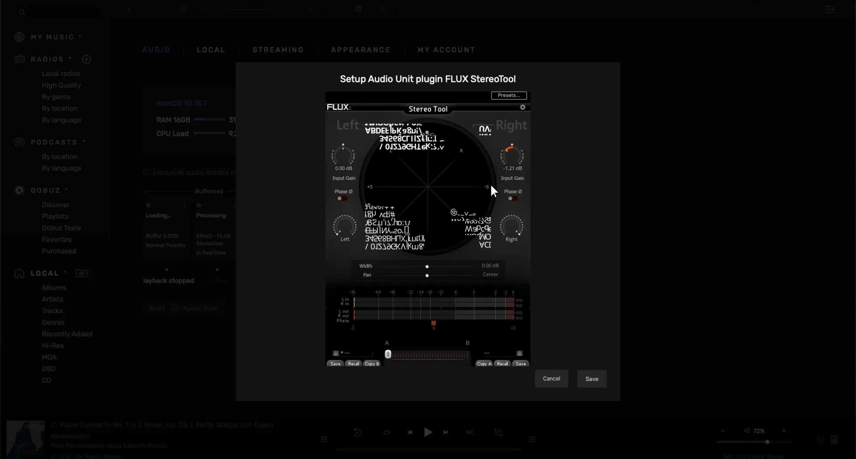

Flux Stereo Tool doesn’t work and the interface is very disturbed
@Antoine

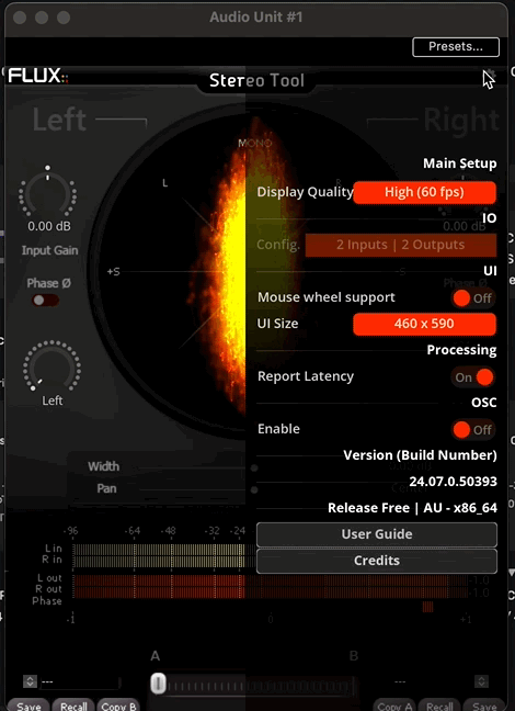

If you play a song with Realtime option enabled in the plugins settings of Audirvāna, do you better see the plugin?
No, not at all. The interface is disturbed and there isn’t input

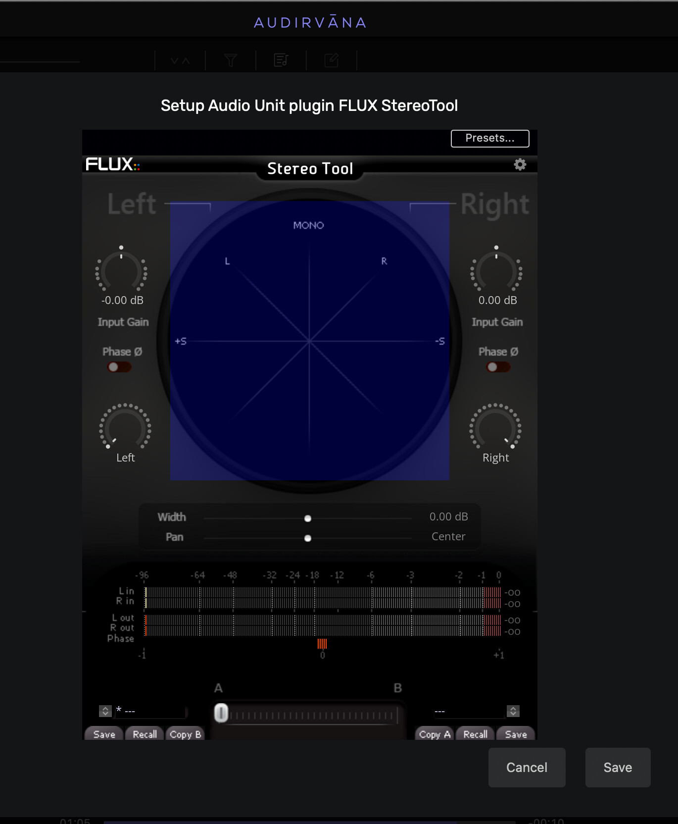

Can you check if you are using the latest version of the tool?

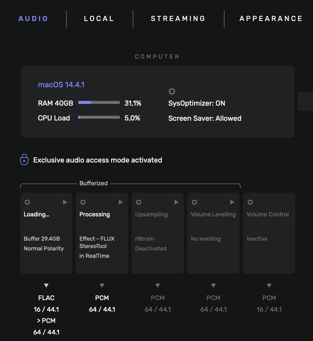

this is what I have on my side:
FKux

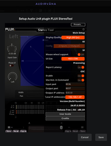

Yes Now the UI is good, but no input

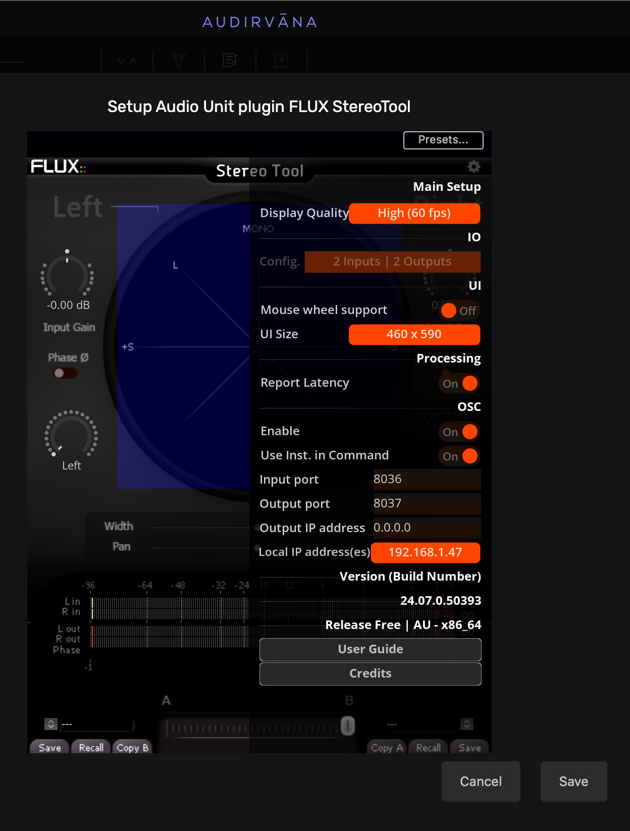

And without OSC enabled?
Same
And no real time works, but it is activated
I think I know what is happening. You are outputting to your Atoll, right? In that case, it won’t work in real-time as you are using a UPNP device.
Then?
You’ll then have to deactivate the real-time option and make the change in the plugin without seeing it before you play your file.
Is there a way to working with Atoll?
And also in not real time, it doesn’t work.
