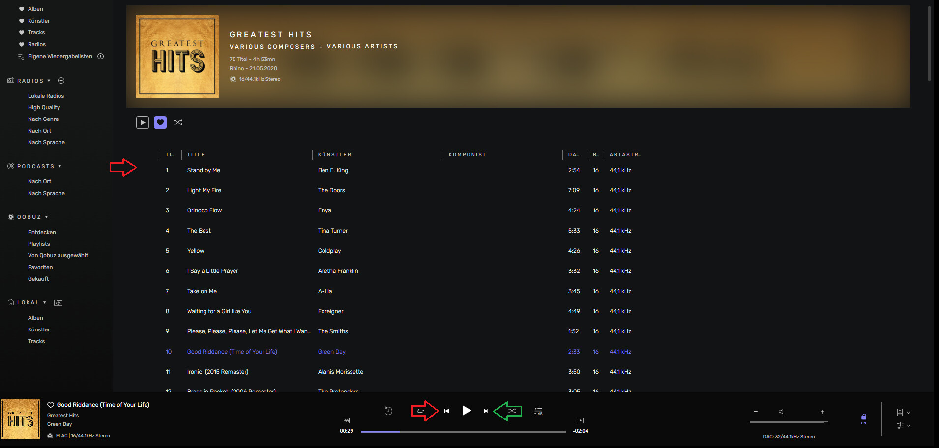

My problem is that Audirvana Studio freezes for 2-3 seconds when i change songs.
If i change my songs with these two options (red arrows in the picture below) there are a delay/freeze for 2-3 seconds in the interchange.
If i change my songs with this option (green arrow in the picture below) there are none/minor delay/freeze.
