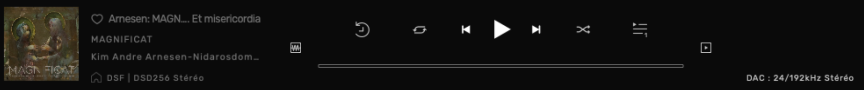

I can play DSF files 64/128 and 256 with these settings (Plugin Active, Integer Mode ON and DoP 1.1)

It’s OK.
You debug report shows the DAC only supporting PCM to 192kHz,…
The DoP 1.1 carrier signal for DSD64 is 176.4kHz and the DoP 1.1 carrier signal for DSD128 is 352.8kHz
I recommend increasing your pre-load buffer back to where you had it for flawless DSD64 playback.
Also, if you are playing .dsf files this alludes to these being extracted from SACD ISO files… Be aware these files can be corrupted from a bad extraction process and they must be extracted to the native DSD64 sample-rate.

@icekill
It’s not OK… You should see the DAC as running as DSD256 or given the max PCM sample-rate of 192kHz the Hegel is showing in the debug report, you would see the DAC running at DSD64 if the file is DSD64
Hegel is not in the numbers game. It’s a PCM only DAC.
Nothing wrong with letting Audirvana down convert to PCM and play it like this.
No, it handles the DSD 64/128 through USB:
Increasing the buffer size does not change anything.
