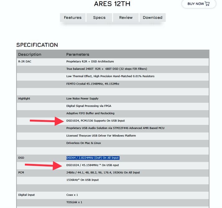

Denafrips Ares II, apparently.
From what is in the manual only DoP64.
How is a DAC R2R do not know.
Specs - ARES 12TH | Denafrips
How strange - in 2020, someone reported in this forum that they had been doing DSD512 on a Mac with the Ares II, but could not get their Holo Audio May to do more than DSD256 from the same computer.
Edit: I think if you look at the PCM specs, you’ll see what they mean is that you can be assured of a minimum of DSD64 using any of the inputs. This is not a maximum for DoP on the USB input specifically.
