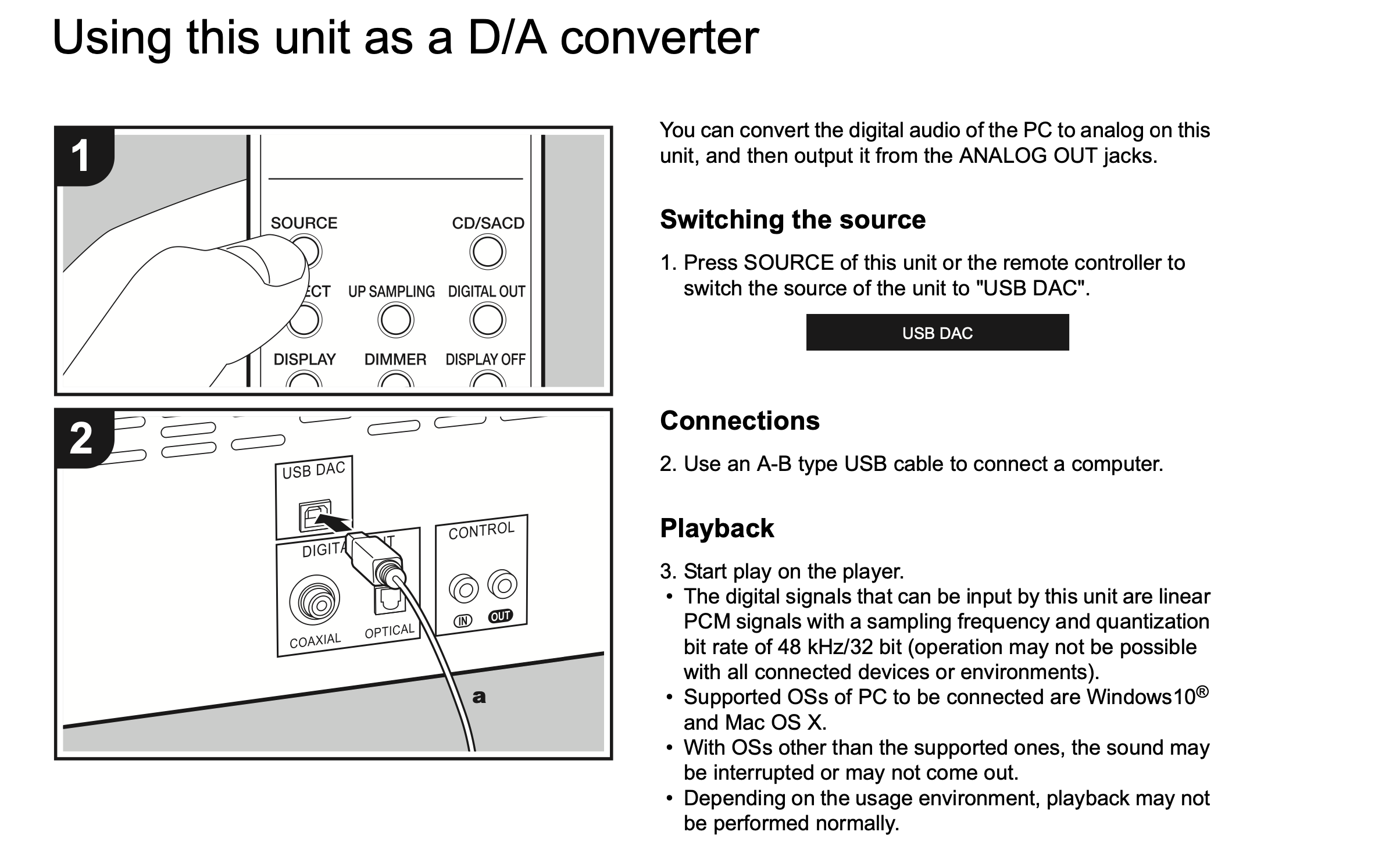

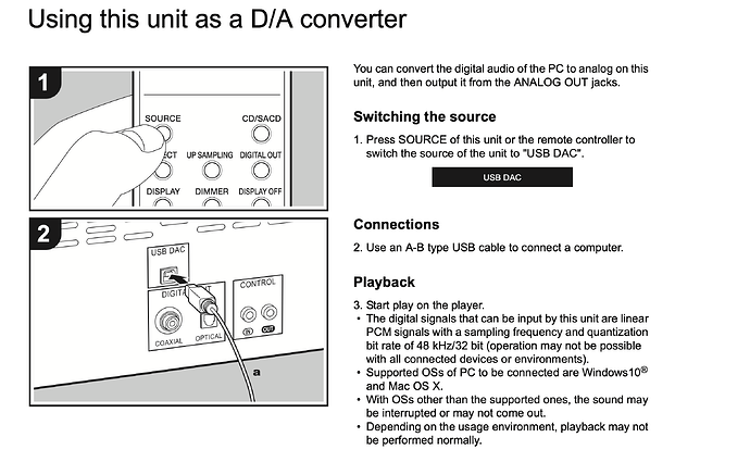

This is from the PD-50AE Player manual:
Thank you! I had been looking at the German version of the manual. The translation of the first bullet under 3. was unclear, while I read this here to mean that DOP is not supported.
My understanding of DOP is that it serves to let computers route an unsupported DSD signal embedded in supported PCM. It probably does not do the same for DACs which do support DSD (like this one obviously does) but only accept PCM from an external source.
A pity.
Thanks again.
DoP (DSD over PCM) is a means of transmitting DSDxxx files via a PCM carrier and the DAC must support DoP signals and the relative PCM DoP carrier sample-rates in order to extract and play the DSD file…
The PCM DoP carrier sample-rate for DSD64 (2.8MHz) is 24/176.4kHz.
