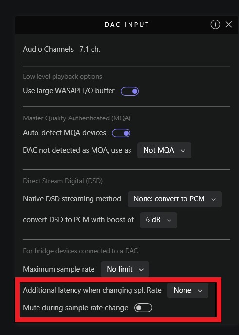

How do I configure Audirvana to increase the sample-rate change time and mute during sample-rate changes?
I have tried Audirvana Origin on Windows 11 and Audirvana 3.5 on macOS Sequoia, unfortunately could not find a way to do this.
Thanks for the screenshot, but I thinking those configurations are for bridging devices.
In my case, the DAC204 is directly connected to the computer via USB.
And I have tried these configurations, they do not resolve the popping sound issue, unfortunately.
