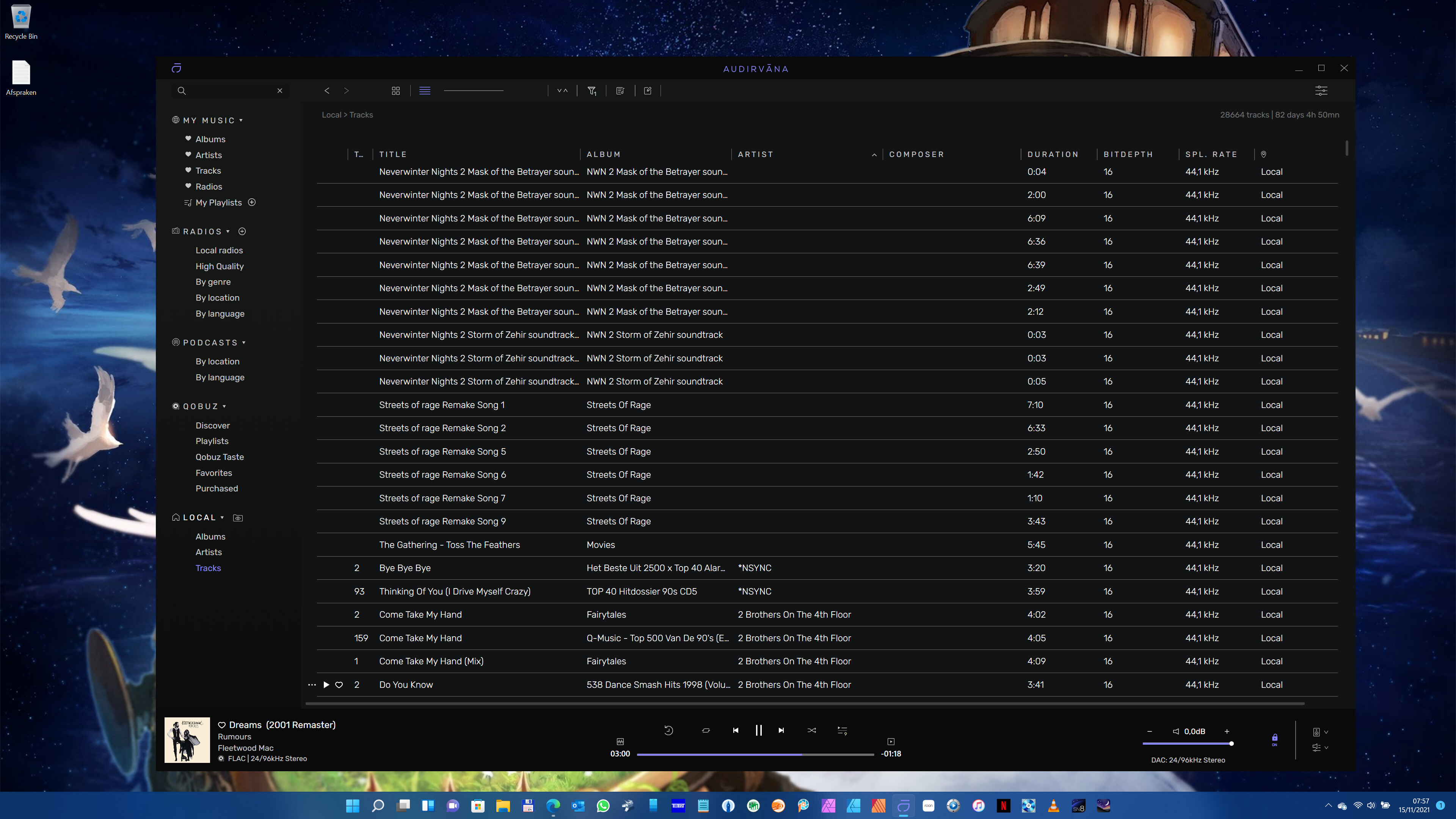

I guess the way to go for you would be to select Local → Tracks on the left menu.
Here you’ll get a full listing of the local music files that Audirvana has imported. Clicking on the listed categories will sort them out that way.

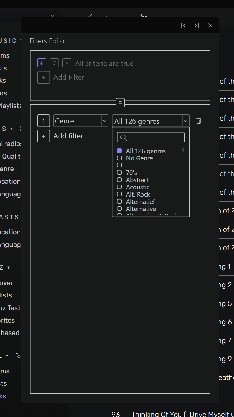

Near the top you’ll find several options.
Edit filters, Playlist Editor and Edit Meta data.
If you click on the Edit filters one, which to me appears like a funnel which you’ll use when putting oil into your cars engine. You’ll open up the Edit filters window.
Here you can add filters to help you with searching. I’ve added Genre here. Now when with Genre selected by default it will show everything. However if you select a genre from the available ones. Only those music files which have that genre in their tags will show up in the main track window. This way you can also show multiple genre’s at the same time by selecting several genre’s.
It’s a bit cumbersome as I haven’t found an option to add genre to the main window. Just like you can in JRiver. Audirvana definately can learn from this imho :smiley:
