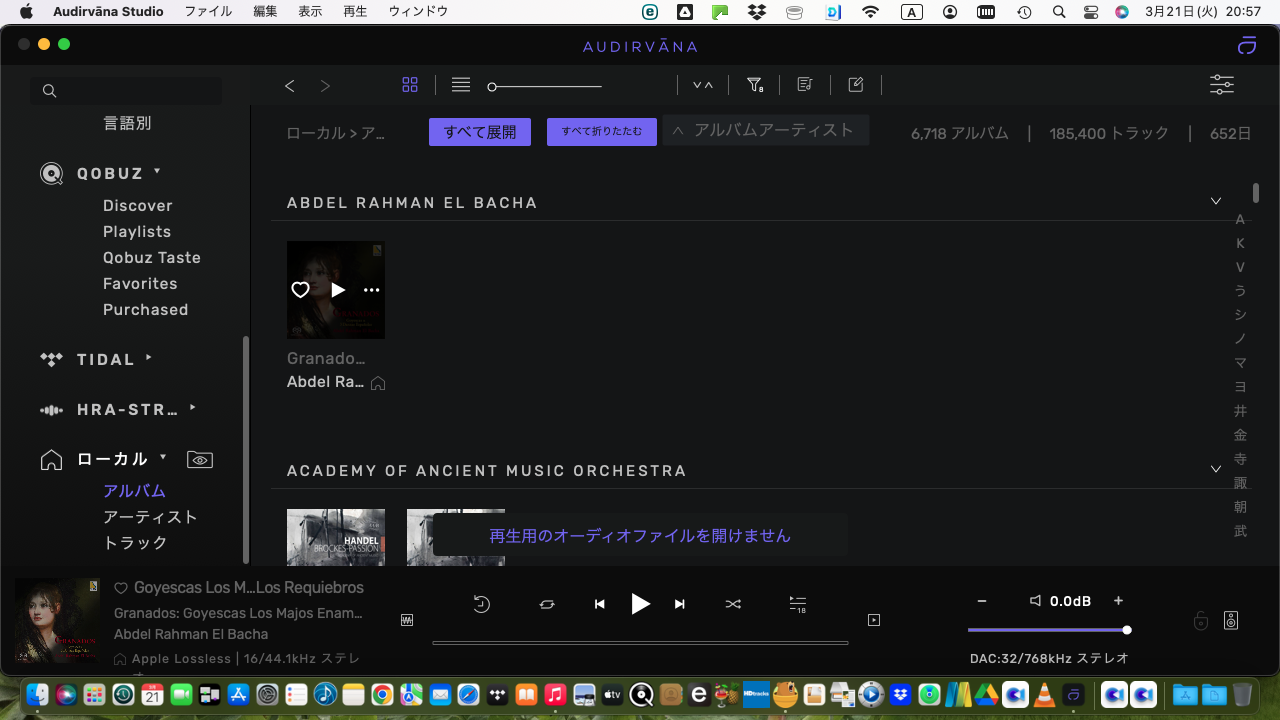

I can not connect to Apple music
Macmini have connected to Apple Music.
But can not play music.
I can see all arubams ,but no playable files.
Please teauch me how to connect music files.

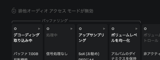

Can you disable upsampling and then send us a screenshot of Audirvāna Studio while you have the issue?
スクリーンショット 2023-03-21 10.07.45
スクリーンショット 2023-03-21 10.08.29

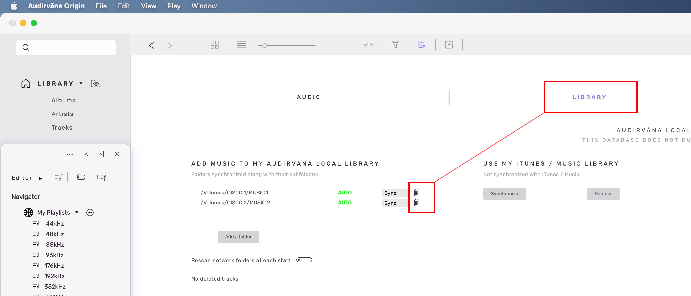

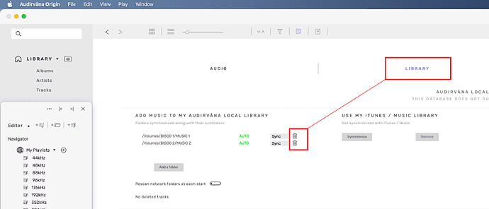

過去の同期フォルダ /Volumes/Logitec Music/CloudStation/Logitec Music/MediaCenter を削除できません。

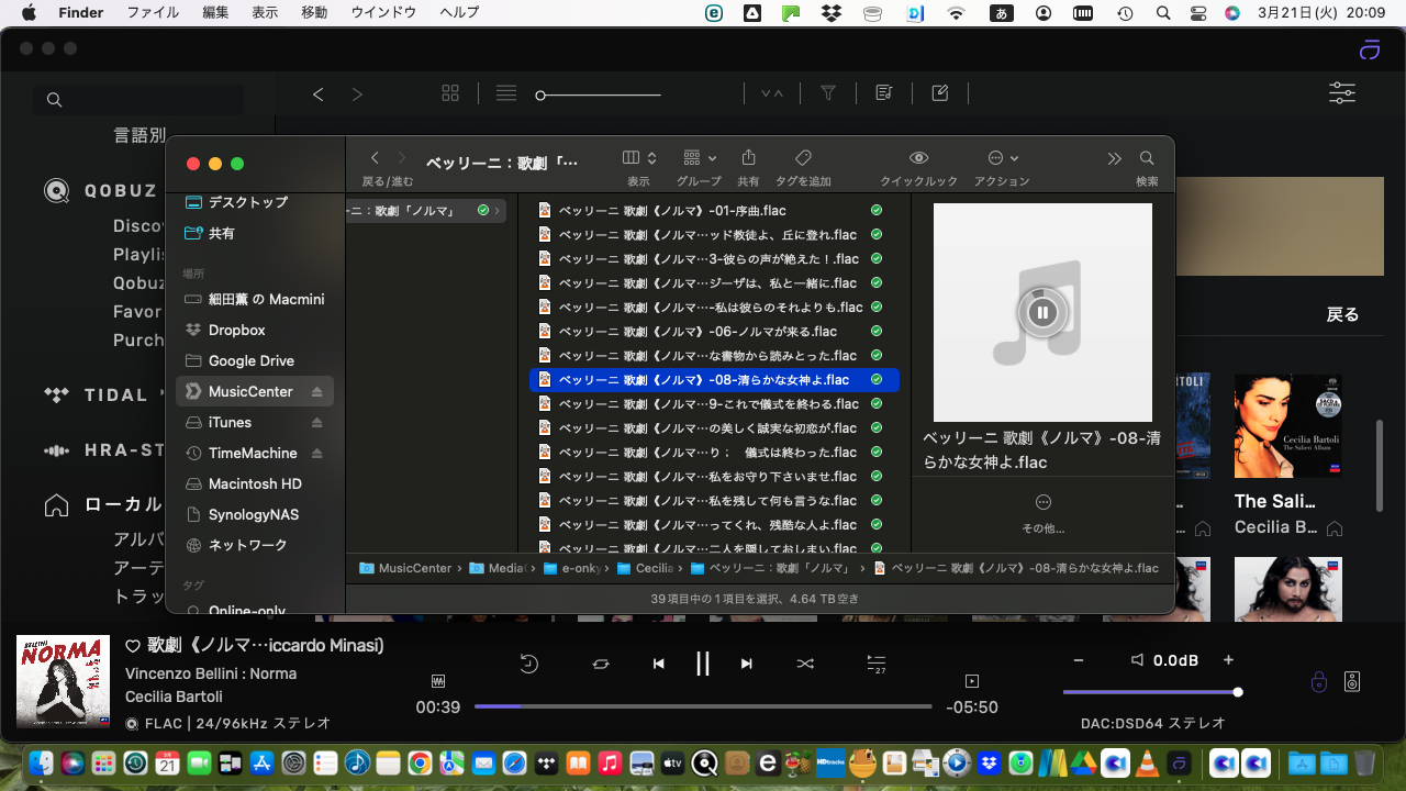

Do you have access to this folder when you are using Finder?
I have acces to folder(in MusicCenter) when I am using Finder.
But I can not acces to folder(in Apple Music) when I am using Folder(CD downlouded).
Why can I not acces?
OR Why is there double folders ?

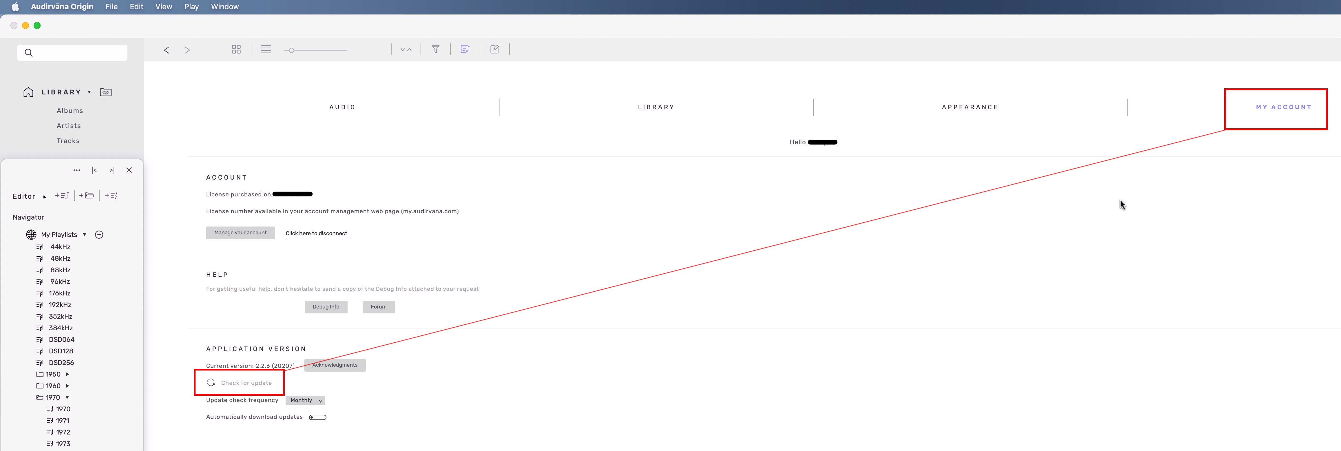

Hi @11166,

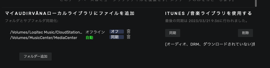

We have made an update today can you install it and then try to remove the folder from the synced folder list?
How can I install and remove folder?
Thank you for your advice.
I could install and remove old folder=/Volumes/Logitec Music/CloudStation/Logitec Music/MediaCenter .
But the situation remains the same and the issue is unresolved.

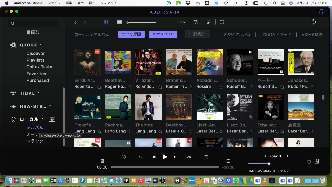

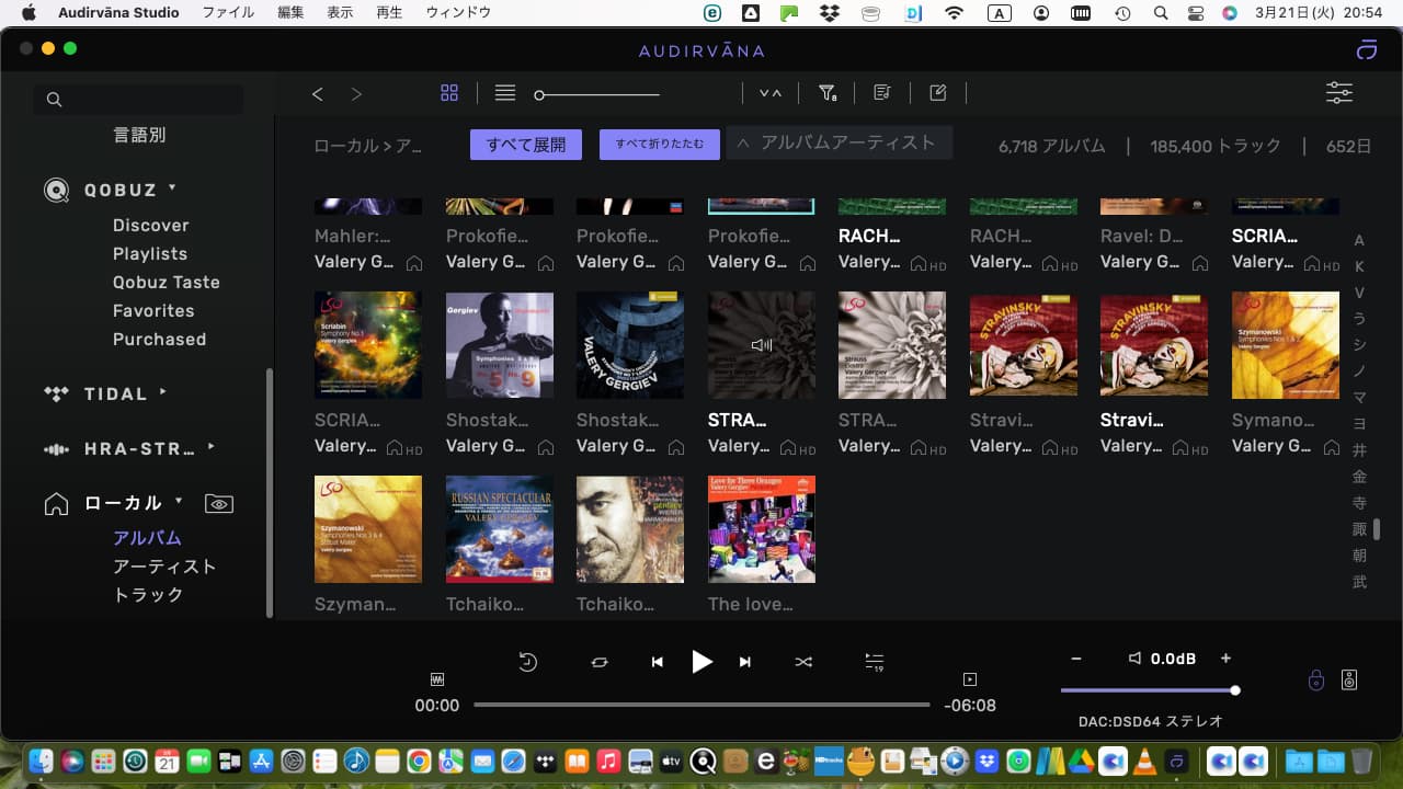

All playable files have their title names shining white.However, files with pale white titles cannot be played,
Plese help me.
Can you also try to remove the iTunes sync to check if you still have the grey tracks?
I have removed the iTunes sync to check. But still have the grey tracks.

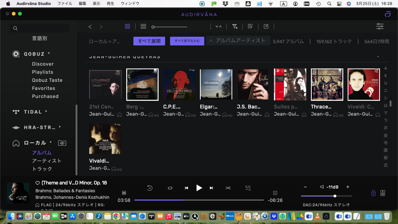

スクリーンショット 2023-03-25 11.10.23
All the files are cannot be played.
I had no choice but to sort the files by album artist and remove the unplayable albums for each duplicate file.
(before)
(after)

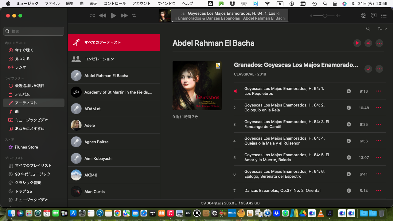

Even if delate a large number of files, many albums will remain unplayable. Apple Music albums, in particular, cannot be played unless downloaded.
Please help me !
It’s probably related to this:
  • the iCloud/iTunes Match tracks, using an iTunes specific protocol for retrieving the audio data. To get them to play in Audirvana, you need to download all the songs you want to play thru Audirvana into your computer library by clicking the cloud icon present showing the album is in the cloud, not the library.
Can’t play without downloading? So how can I delete all unplayable files? I want to delete not only Apple Music but also unplayable files synced with external hard disk.
