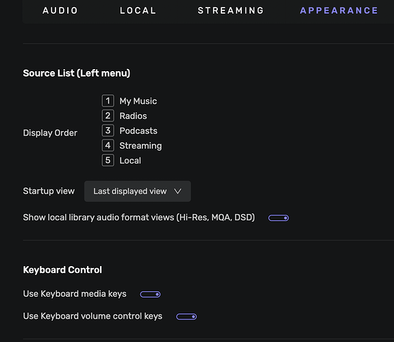

I presume you have those options enabled in the Appearance settings?
I tried several setups as I also use Rogue Amoeba’s SoundSource and Loopback, as well as Realphones. If I bypass (checkmarks off) the Audirvana Keyboard control, it’s a hit or miss situation with these other tools activated, sometimes I can access volume keyboard keys, sometimes they do not respond. I now found that I am better off not trying to integrate certain of these tools with Audirvana. Specifically not trying to reroute it at the SoundSource level. Thanks.

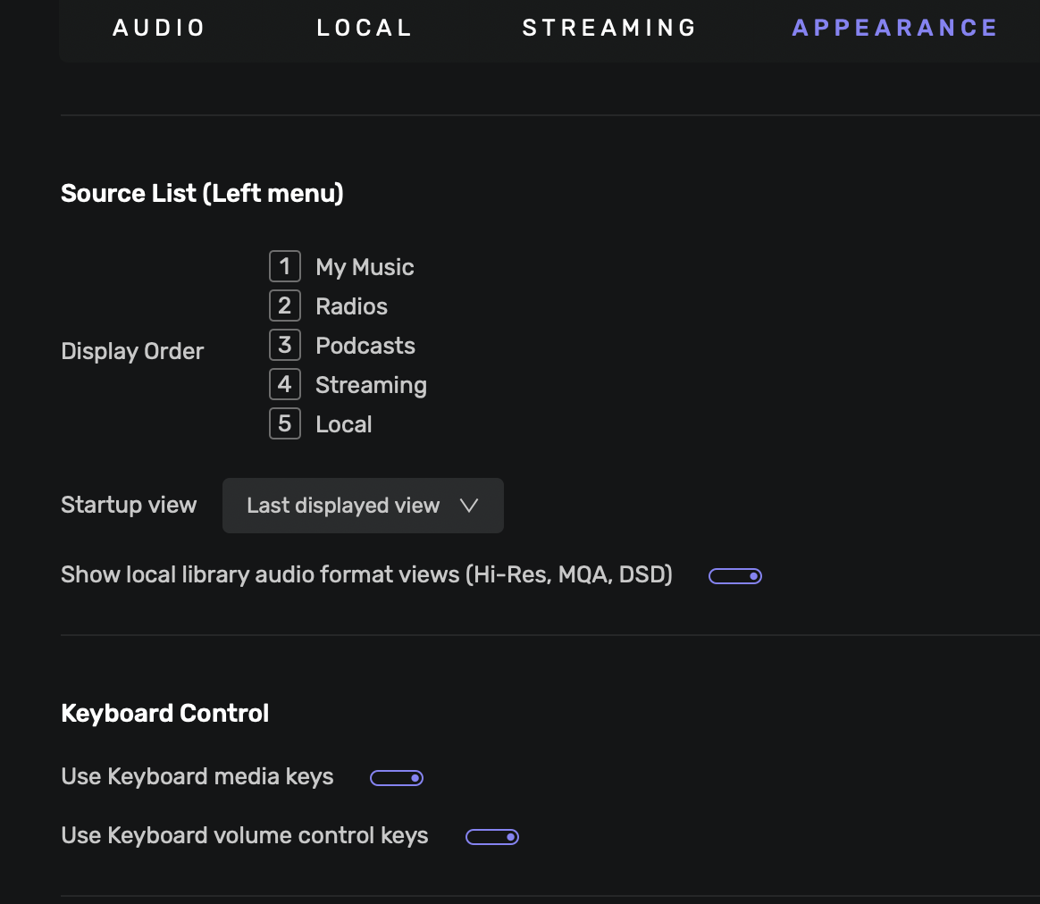

I can make aggregate outputs AND keyboard keys work if Keyboard Control (both) in Appearance are OFF. Then I select my Aggregate in both Audirvana as output and in SoundSource. Then it all works as I expect, Android remote included. I’m all set I think…
