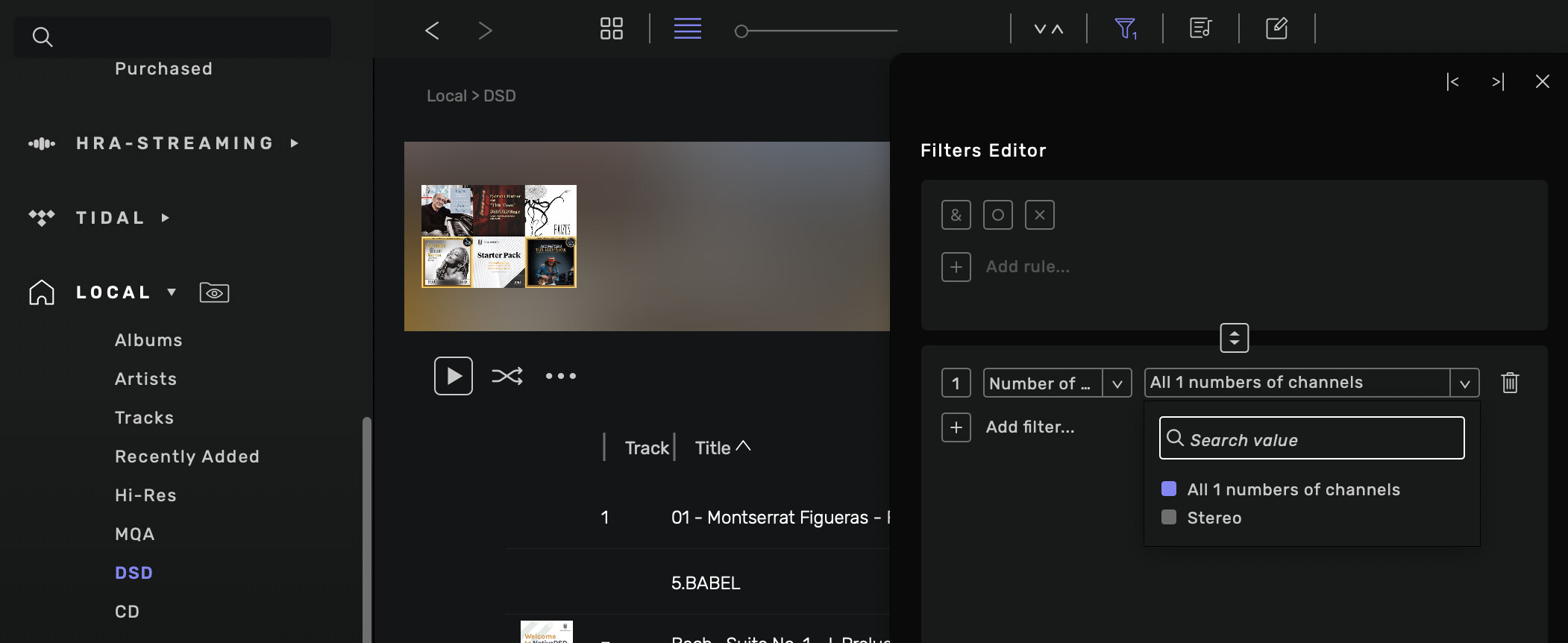

Have you added the Channel/Number of Audio Channel to your view while looking at Tracks? I do not have nearly as many as you but I do see what tracks/albums are Stereo; 5 Ch.; 6 Ch. Of course, you also directly create Smart Playlists with the same Channel field values.
Hello @jlm70,
You should be able to filter the view the way you want:

I’ve created smart playlists, and I’ve seen that the “number of channels” is connected to the %MODE% tag within the DSF files.
The problem I have is that I find MANY (almost all) duplicated albums and tracks (while I’m sure that there’s a single copy of the file in my NAS).
For instance if I apply the 2 channels filter, I have an SACD album that has 3 times the first (SACD stereo) track, 3 times the second, the third, etc.
If I remove the filter I see 4 albums (instead of one), some with a mix of stereo and 5.1 tracks, some only stereo… a mess.
I used mp3 tag to review the tags and everything seem perfectly fine, so… really do not understand why this dupes and wrong assignments.
May I MANUALLY move one file from one album to the other, so to “build” a single album with all the tracks (stereo and 5.1), and then deleting the dupes, so to reorder everything?
At the moment I do not know how to move some tracks from one album to the other… I can only delete them from the library.
