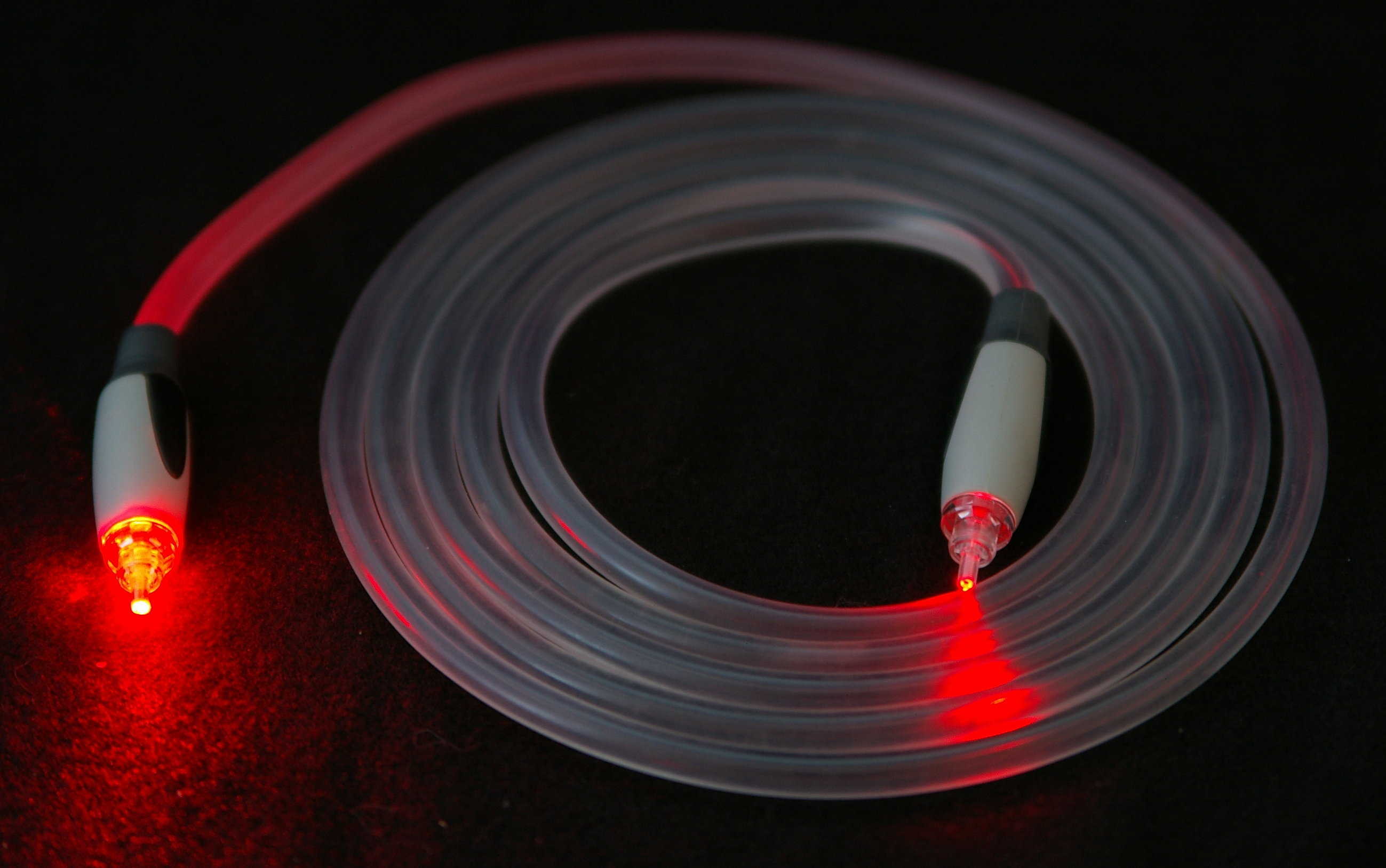

So, it is unclear the D40 DAC supports USB protocol transmission from a computer…It may not, and this would not be unusual… Try running an optical S/PDIF cable from the headphone output of your Mac to the optical input of the D40 DAC… Otherwise you can use a DDC to convert the USB signal to 44.1kHz S/PDIF optical… or use the analog output of another DAC to playback high-resolution signals via the AUX input of the D40… In all cases, the D40 DAC only supports PCM signals to 44.1kHz.

You can implement a ‘Custom’ sample-rate conversion strategy like the one I describe below, when you have a proper S/PDIF optical connection made to the D40 DAC…
44.1kHz → 44.1kHz
48kHz → 44.1kHz
88.2kHz → 44.1kHz
96kHz → 44.1kHz
176.4kHz → 44.1kHz
192kHz → 44.1kHz
352.8kHz → 44.1kHz
384kHz → 44.1kHz
