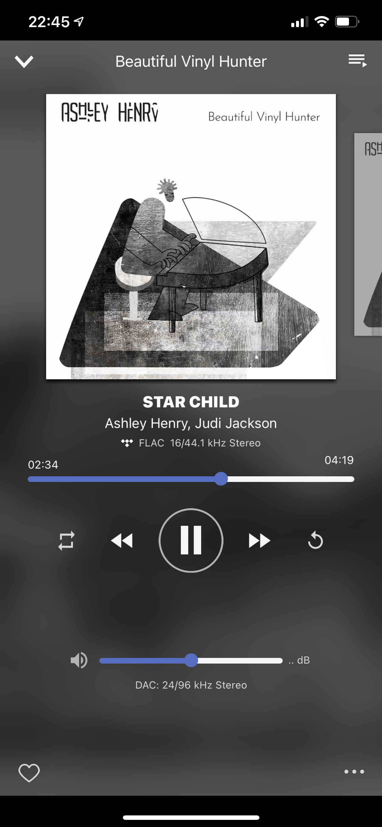

I am having the a similar problem with the remote when using Audirvana to control the volume. Often times when first starting the remote application or changing albums, the volume setting on the remote automatically moves to the middle of the slider graphic which results in a huge and unsafe volume increase.
The volume control on the remote could also be much improved. The slider is too small and should be larger and more easily toggled. The volume control function should also be made to default to infinite db when the app is started or when changing albums as a safety feature.
By the way, I am using Audirvana with a Benchmark HGC DAC2 that has the volume potentiometer at 0 db to effectively bypass that device.

New user here still in the trial period, I’ve just experienced a very dangerous volume increase using the ios remote volume control when connected to my uPnP amp. Really a very very bad experience for me, this is just not safe.
After it happened three times I have deleted the app, distorted sound from my speakers at ridiculous volume levels. NOT HAPPY
Is there any update on when the mobile app will be updated to fix this volume control issue?
Hi Damien, I am also experiencing the problem, that the volume setting of the remote is not corresponding with the setting on my mac. This is very dangerous. Is there any solution ahead?
