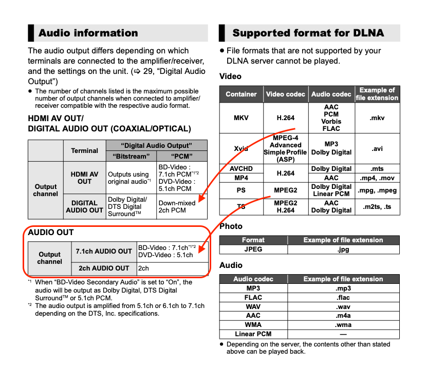

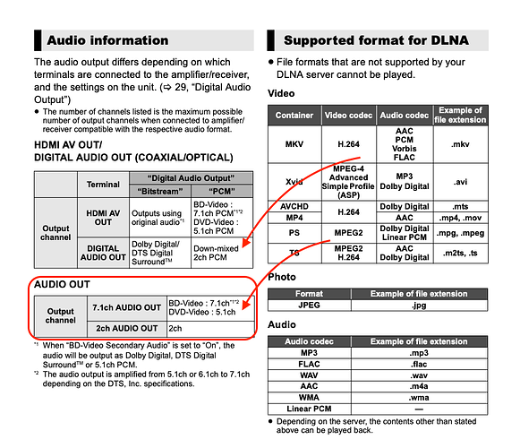

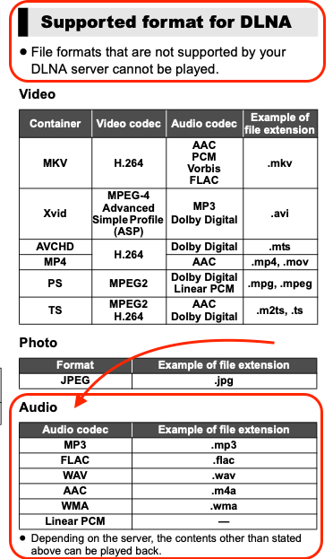

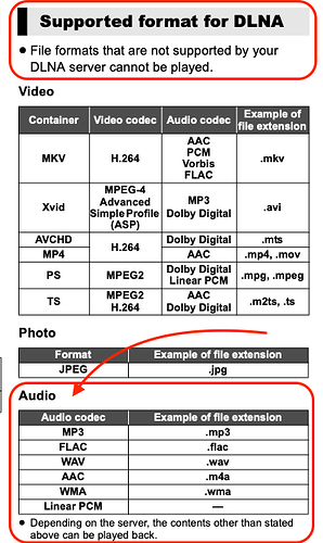

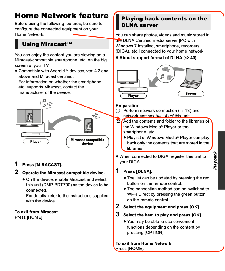

From the BDT700 player User Manual linked above:

There is nothing about UPnP support stated in the User Manual… Why do you think the player supports multi-channel UPnP protocol? :thinking:
Link to User Manual:
https://www.panasonic.com/content/dam/Panasonic/MEA/pdf-download/DMP-BDT700.pdf
