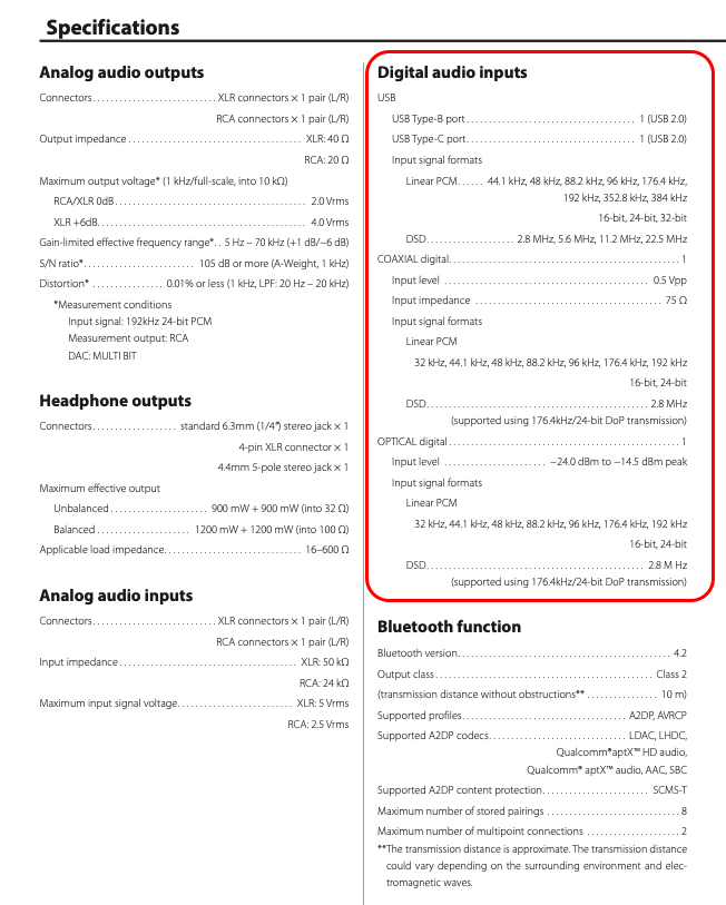

I can choose DOP 1 or 1.1 but no way to use the DAC TEAC UD-507 max upsample DSD capability, as with MacOS.
the app see 512 max and the TEAC is labelled as “play with”.

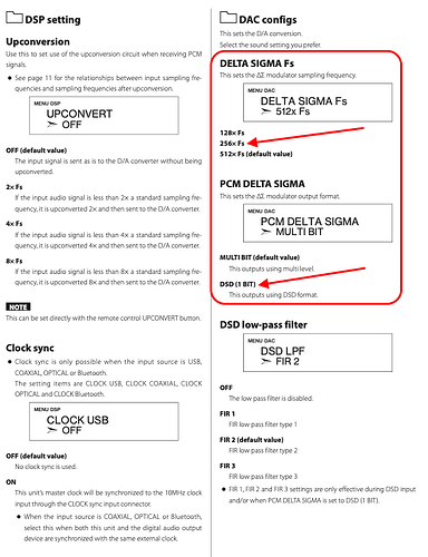

the DAC config 128, 256, or 512 Fs is the setting where I can choose the DSD upsample output ?

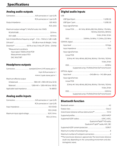

I had a moment and another thought occurred to me. Usually a DAC capable of DSD512 will also be capable of 768kHz PCM. But your DAC’s specifications appear to me to say it is limited to 384kHz PCM. If this is correct, the DSD512 capability may be the result of a driver not available in Linux. Experiencing the same limitation with both Audirvāna and HQPlayer might be an indication this is the case.
Just a thought, perhaps correct, perhaps not.

:roll_eyes:… The UD-507 is a proprietary ladder-DAC that upsamples/modulates everything to DSD and outputs the signal as either 1-bit DSD or Multi-bit DSD-Wide… This DAC does not support PCM sample-rates above 384kHz. There is zero reason to.
There are no recordings done at 768kHz, These are all iterations of lower PCM sample-rates up-sampled to 768kHz.
There are very few recordings produced using 1-bit 11.2MHz (DSD256) A/D… I think Octave Records (PS Audio) is beginning to build a catalog of content recorded at 22.4MHz.
There are zero 22.4MHz (DSD512) recordings. These are all iterations of lower sample-rate 1-bit recordings or up-sampled PCM recordings.
The UD-507 modulates all PCM signals to 1-bit DSD… The modulator frequency can be selected between DSD128, DSD256 and DSD512
