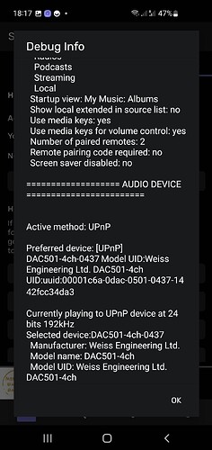

I need the debug info, not the log file :wink:
I clicked on debug info a window with all the information appeared, unfortunately it cannot be copied using a galaxy s10 anywhere, do you have a trick that I can use to copied it? I tried taking a picture,
