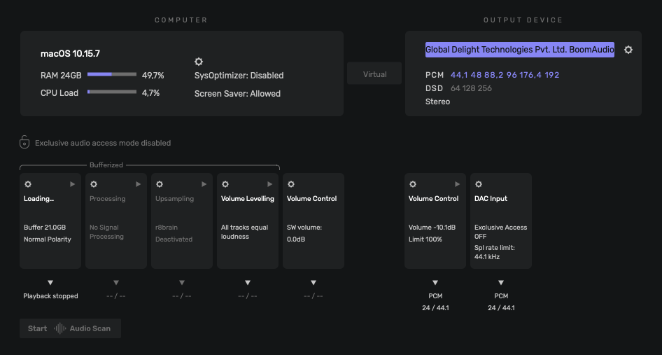

Hi. Occasionally playback stops just a few seconds before the end of a track and not continuing to the next track.
Looks like it has something to do with the audio buffer/cache? I dunno. See screenshot below. Notice the gap in the buffered content at the end, resulting in the sudden playback stop.
I don’t use any plug-ins. All tracks are local music on my external Drobo Thunderbolt storage.
macOS Catalina 10.15.7 (19H2026)
Audirvana Origin v2.2.2.

I’m also using Boom3D (a system-wide audio enhancement app).

One thing I forgot to mention is that I have Boom 3D (from Global Light Technologies) installed. It’s a system wide audio enhancement app for macOS. Audirvana uses it as the output device (as it’s supposed to), but I don’t see how that app causes this issue.
For clarity, here is how the Audio tab in Settings looks like:
For troubleshooting purpose, I’d suggest you try to output from your macOS standard audio, so we can try to see whether that Boom3D has any impact (it totally could).
I have no technology background so I can’t help you any further. I’d recommend you to provide the content of your debug info (Audirvana’s first menubar item) into a hidden text tag so the programmers (usually @Antoine ) can check.
Good luck !
Thank you. I’ll do what you suggested.
It’s possible that this app create issue with Audirvāna Studio as it is accessing to the CoreAudio of your Mac and do some modification to it. If you can try to a different output, do you still have the same behavior?
