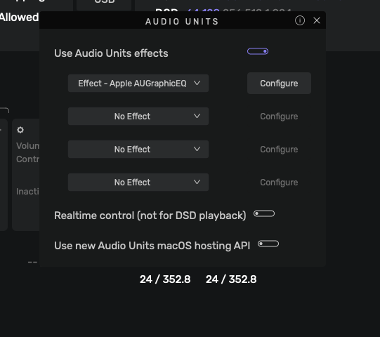

It looks like I have resolved my issue. The “Use new Audio units macOS hosting API” needs to be off. I’ve been testing this last couple of weeks and when off the issue does not occur. I’m not saying 'resolved" I’m saying…, at this stage all works right when off.
Regards
Phil
Screenshot 2024-12-17 at 2.48.20 PM
