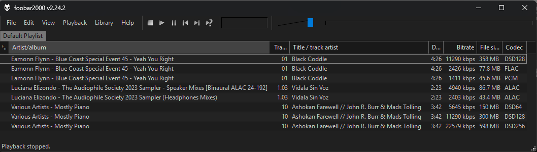

So, after having rolled back the Mojo 2 driver to the original, which I downloaded from Chord’s website, and whilst waiting for Chord’s response on the next steps, I thought I would try another player.
I updated my foobar2000 (32-bit) installation to the latest version. I only used to run its Dynamic Range Meter plugin but never used fooobar2000 as a player.
Lo, and behold, ALL tracks play fine via foobar2000! It appears that the Audirvana + Mojo 2 combination is the problem. As such, I would welcome some insights as to why this is so, and whether anyone else has had issues using Chord DACs with Audirvana running under Windows 11 (64-bit). Here is the latest Debug Info:

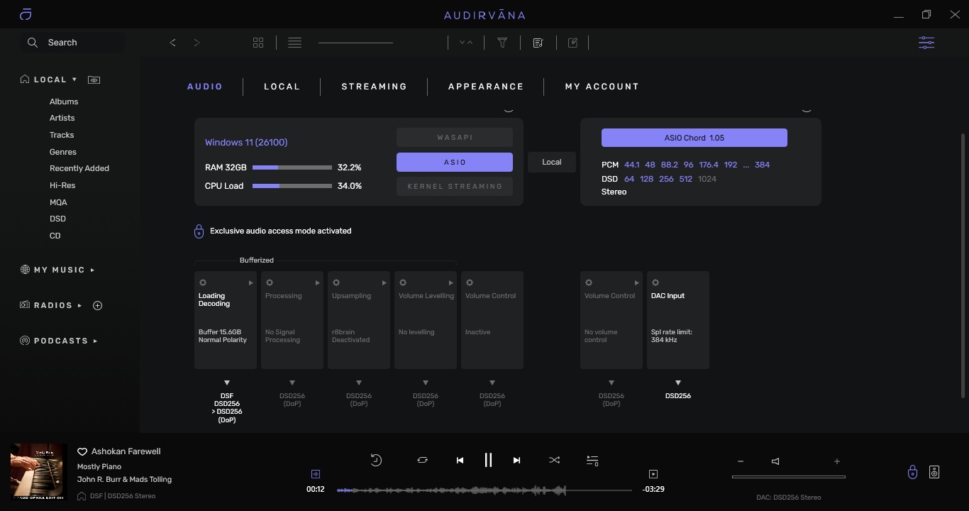

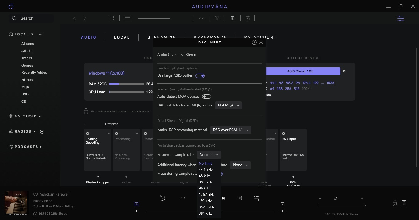

Try changing ‘Sample rate limitation’ to 768kHz in “Bridge settings” and your ‘DSD via PCM’ protocol to DoP 1.1. in “DSD capability”
I also suggest lowering your playback preload memory allocation to 4GB or 6GB.
If you are using EQ DSP in the Mojo box, and boosting frequencies and adding gain, you may be clipping the Mojo DAC…

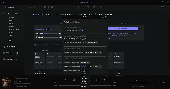

Having said that, rather interestingly, the maximum I can set 'Maximum sample rate is 384kHz, not 768kHz as one expects.
Note that this is when Chord’s ASIO driver is used. Why is the PCM sample rate showing 1,536 when it should be 768?
Given the glitching/static occurs when using both ASIO & WASAPI, I don’t think this is the root cause of the issue.

Set the ‘Bridge settings’ Maximum sample rate to the 384kHz limitation.

With a PCM limitation of 384kHz, the highest 1-bit DSD sample-rate transmittable via DoP would be 5.6MHz (DSD128).

  2. What is the reason for setting the ‘Maximum sampling rate’ to 384kHz, since playback appears to be at DSD256 (11.2MHz) anyway - the Mojo 2 indicates that it does receive a DSD stream (via its indicator light), but not the actual sampling rate - see below:
  3. I did try DoP to v1.1 as well, but no joy. Where can I find a good explanation of the differences between DoP v1.0 & DoP v1.1?

Note the bold text in the report data when using ASIO Chord 1.05… Audirvana only sees 384kHz capability in the Bridge settings… The incongruences pose a question as to the Windows 11 DAC connection potentials playing into these behaviors you are experiencing…
Selected device:ASIO Chord 1.05
Manufacturer:
Model name: ASIO Chord 1.05
Model UID: ASIO Chord 1.05
12 available sample rates up to 1536000Hz
705600
768000
1411200
1536000
If Audirvāna sees the DAC as capable to 384kHz, where 352.8kHz is the DoP 1.1 PCM carrier sample-rate for 1-bit 5.6MHz (DSD128) it is apparent that when a DSD256 (11.2MHz) signal is presented, the DAC does not play it properly or at all… If it does play the file, the DAC may be having difficulty handling the de-embedding of the 1-bit 11.2MHz PDM signal from the 705.6kHz DoP carrier sample-rate and producing artifacts in this processing.

Not quite, since the issues occur ONLY when the following combination of devices and software/hardware are in the chain:
Audirvana Studio (v2.9.99) => Chord Windows Drivers (v1.0.57.0 & v1.0.69.0) + Chord ASIO Driver (v1.0.5) => USB (A → C) Cable => Chord Mojo 2
The following combinations work without any issues:
foobar2000 (v2.24.2) 32-bit => Chord Windows Drivers (v1.0.57.0 & v1.0.69.0) + Chord ASIO Driver (v1.0.5) => USB (A → C) Cable => Chord Mojo 2
Eversolo DMP-A6 Master Edition => USB (A → C) Cable => Chord Mojo 2
NOTE: The same tracks (shown below) and USB Cable were used in all tests.
As such, it is clear that the issues occur when Audirvana, coupled with Chord’s drivers, is in the chain.

We see in the debug report only the ‘ASIO Chord 1.05’ as the UID of the selected device and as ‘Device #0’ in the "Local devices found’ listing… It appears that the Chord Mojo hardware ID is not identified… We see your other DAC UID’s describing the hardware device attached… As I alluded previously, if your other DACs playback files as expected via Audirvāna, it is obvious there is a connectivity anomaly with the Chord box.
If you are using a USB hub or connecting all your DACs to the laptop via the USB ports, try connecting the Chord DAC alone, directly to your laptop so to eliminate any USB bus potentials in the context of Audirvāna playback.
What happens when you disable ‘Integer Mode’ playback?
Okay, in order to isolate this issue, I have now removed the Conexant HD Driver (installed by Windows), and ensured that both ASIO & WASAPI settings are the same as far as permissible.
The debug info was captured while playing one of the PCM test tracks at a sampling rate of 192kHz - NO CHANGE to the issues identified earlier. Further, the glitching/static seems to get worse when I work on the laptop (i.e. use the keyboard, mouse, etc) - this exactly is my use case since I will be working on the laptop while Audrvana is playing music via the Mojo 2 (i.e. casual listening). Audirvana plays via a dedicated headphone system (Iris DDC → Denafrips DAC → SPL Phonitor 2 amp) which plays fine, if required, up to and including DSD1024.
Pasted below are the two lots of Debug Info following these changes:
