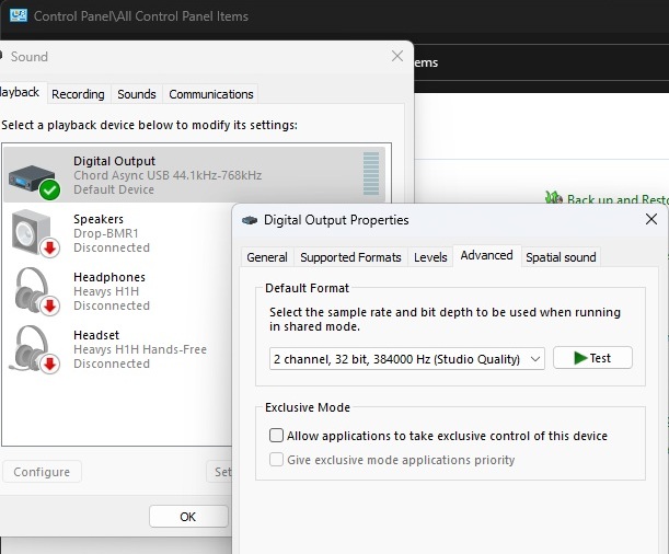

Have switched off Exclusive access via Windows Sound Settings as seen below, but it doesn’t make a difference since Audirvana reverts to exclusive access on playback:

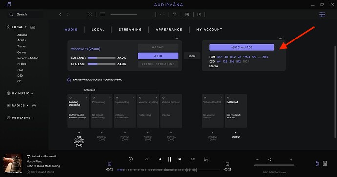

Further, I believe the ASIO driver is common to all Chord DACs, which is probably why the model name doesn’t appear when ‘Debug Info’, is generated, but it does for WASAPI settings since that driver is specific to the model.
Do you not see in the DAC settings pop-up window? This is where the ‘Exclusive Access’ setting is found…

Since your using ethernet/UPnP try Kernel Streaming… That’s what I use… :+1:
Wait did I read that dump wrong?
Note the screenshot above :wink: :point_up:
Local devices found : 4
Device #0: ASIO Chord 1.05
Manufacturer:
Model UID: ASIO Chord 1.05
Model name: ASIO Chord 1.05
Device #1: USB DAC ASIO
Manufacturer:
Model UID: USB DAC ASIO
UID: USB DAC ASIO
Model name: USB DAC ASIO
Device #2: Vinshine DENAFRIPS USB DAC
Manufacturer:
Model UID: Vinshine DENAFRIPS USB DAC
Model name: Vinshine DENAFRIPS USB DAC
Device #3: Zorloo USB Audio ASIO Driver
Manufacturer:
Model UID: Zorloo USB Audio ASIO Driver
Model name: Zorloo USB Audio ASIO Driver
My bad… :clown_face:
