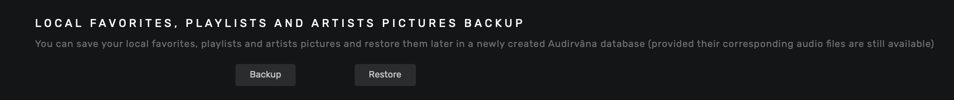

You can back-up all those Playlists by going in the Library section of Audirvāna Origin.

I decided to uninstall and reinstall, which I did last night. Everything works properly now, so I suspect there was file corruption due to the power failures that we have suffered here.
I backed up the playlists before I did so and successfully restored them. I appreciate that Origin has that capability.
