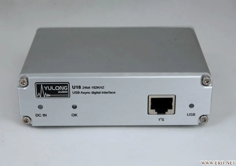

You can try to find some professional interface that does USB to AES/EBU. Even better a streamer that does UPnP that has AES/EBU output. There are some but they come at a price. Not sure if it makes sense for such an old DAC, even though it comes from the masters at MSB. You’ll probably get a better result by upgrading the DAC.
Thanks, bitracer. One correction from my end - I don’t use a CD player. I connect the MSB dac to a streamer (a Allo Digione Signature which is made from a Raspberry Pi). This outputs s/pdif coax to the dac. The system sounds great - especially with all my little tweaks. However, MSB’s literature touts their balanced connection for better sound and I thought an inexpensive tweak would be somehow add the balanced output from the streamer. Thanks for the product notice. I think that Allo has a balanced output option on one of their great products…
