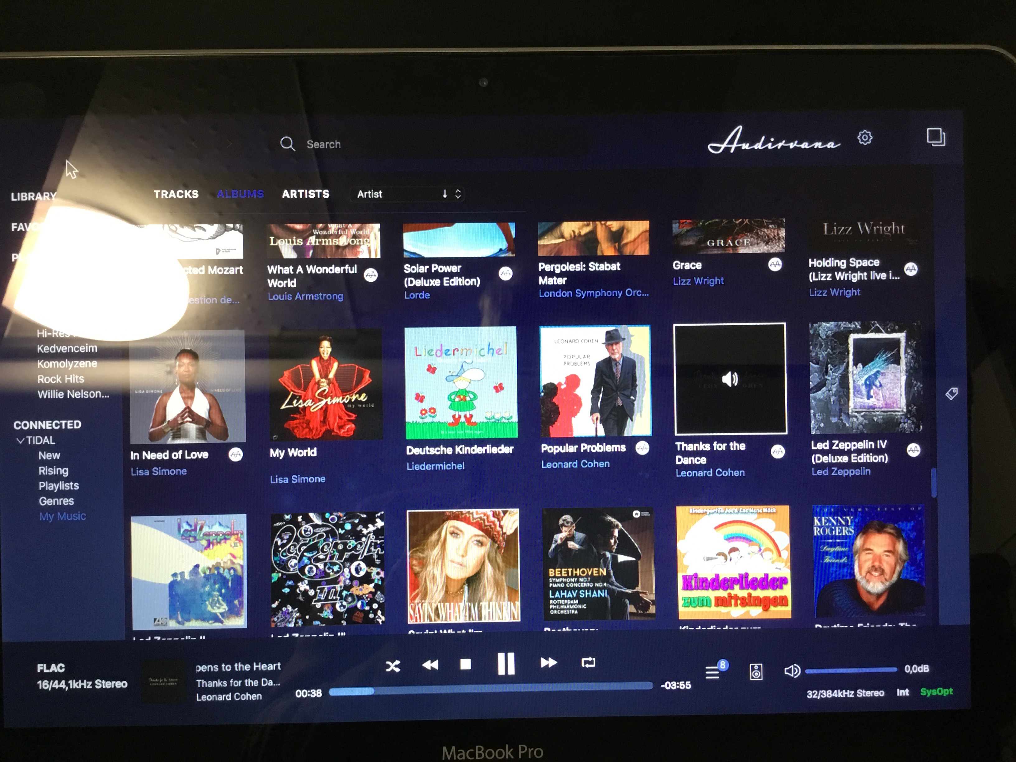

I don’t know what happend, but the MQA HighRes Data seems not to be received or authenticated by Tidal. (Macbook-> ifi Zen DAC v2) So Tidal->Adirvana 3.5 delivers just the 44/16. Is there anything wrong with the Audirvana authentication process with Tidal?

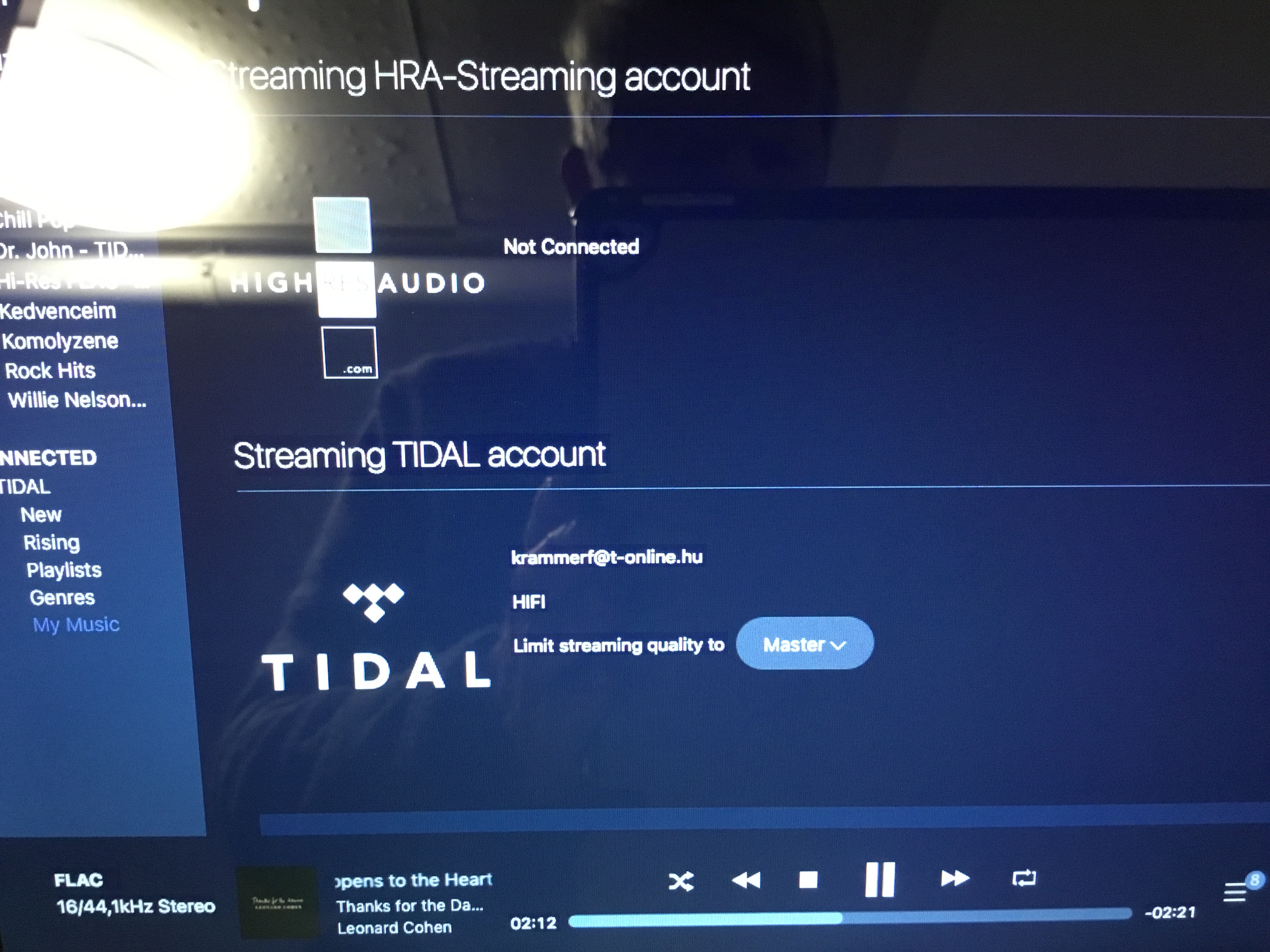

Yep, some here, too … See screenshot.
By the way: I noticed that the Audirvāna streaming settings list my Tidal account only as »HIFI«, while my account is »HiFi Plus« instead. Could that cause the problem?

My settings view is like this:
I don’t use Tidal. This is a print screen from the internet. :wink: I also haven’t read yet how to force MQA via the API, because some users really don’t want MQA and others do.

MQA identification is not the problem (it works), but the »quality«, which seems to be limited to 16/44,1 or 24/44,1.
Colleagues, do not deviate from the original question/request. Open a new topic related to your own subject if it does not pertain to the original topic. In my case, there is no MQA identification; the DAC is lit in white, not purple. The same happened last June. At that time, Antoine wrote this as the cause: “Tidal made a change on their end for our API access without telling us, we are waiting them to remove what they have done so that any version of Audirvāna works again with MQA on Tidal.”

Please comment if you use Tidal with Audirvana 3.5 and a Mac with an external DAC. Currently, I only receive music with MQA marking in a resolution of 16/44.1 kHz. It would be great if Audirvana could also provide feedback on whether there have been any changes regarding MQA. Are there any issues or errors?
