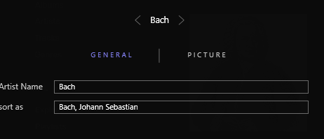

Can some one claify how Audirvana Studio handles Artist Sort
From what I see
It ignores Artist
It ignores Artist Sort if set
It looks up a weird and wonderful mix from presumably MusicBrainz
eg
No where in the file tags is Bach included as an artist
Is there a way turn off lookup and only depend only on file tags

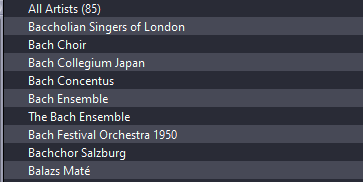

You will have to do a search in the ā€œFilters Editorā€ … Try ā€œArtistsā€ or ā€œAlbum Artistā€ .
I have found many of these instances in my albums.
Sometimes the original tags have composers in some tracks as an artist.

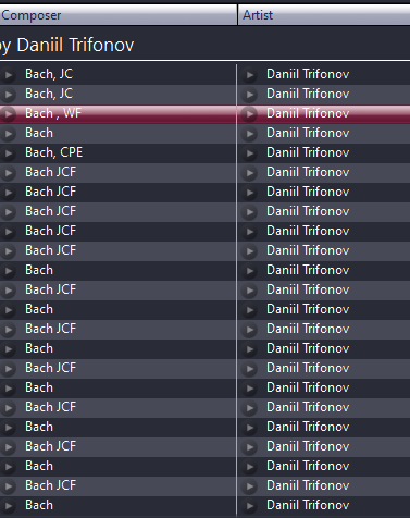

No I am absolutely sure Bach is not an Artist in my library . Composer in the Artists tag is sorted before importing !! It’s one of my pet hates :smiling_imp:
I am somewhat ā€œmeticulousā€ with tags …
It would show in this JRiver view
So it must be coming from something external
Another example
Artist and Album artist set to Daniil Trifonov

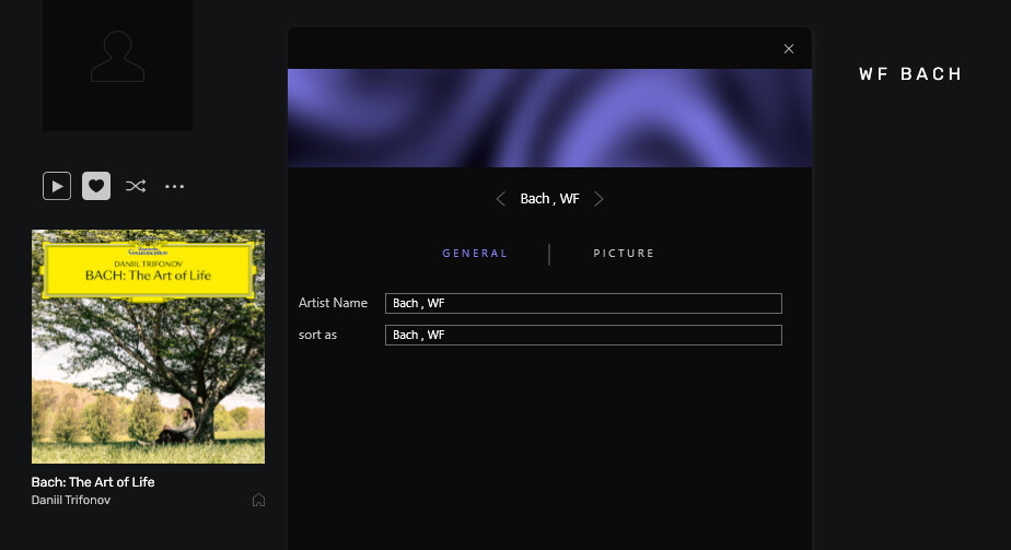

Composer on ONE tracks (Not all) WF Bach, maybe AS is defining [Artist] = [Composer] , the real concern is there is no consistency it happens sometime but not all times.

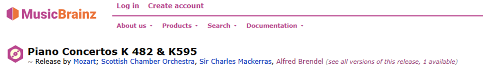

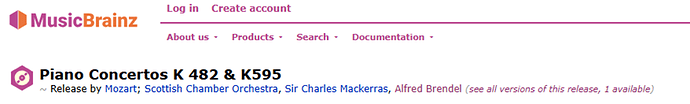

I think I understand where things are going wrong , It would seem that on import, the [ArtistSort] is a lookup from MusicBrainz

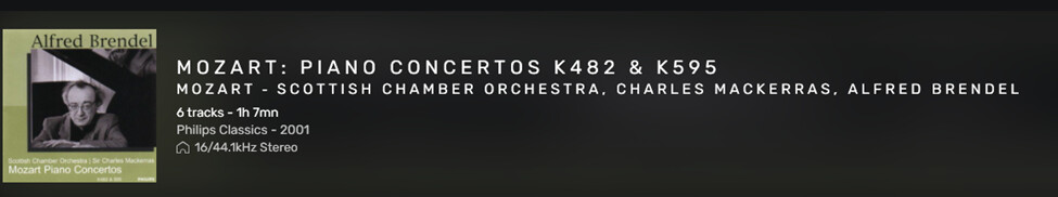

Take this album,
Nowhere in the [Artist] or any other Tags is the Orchestra and Conductor shown in the [Artist] Tag as shown on the AS page.
They are in separate tags [Composer], [Orchestra] and [Conductor] and the [Artist] & [AlbumArtist] both contain just ā€˜Alfred Brendel’
Hence my suspicion that the in file tags are not being honoured and a MusicBranz Lookup is substituted.
A simple config to switch off the lookup would fix the issue and the in file tags could be used.
The other alternative is that the MusicBrainz ID is looked up and stored in the db and then actively looked up as the Album page opens , only you can see what is happening
Bottom line the file tags would appear to be being ignored and causing sorting difficulties as a result. I don’t think adjusting the in file [ArtistSort] tag would help if it’s being ignored.

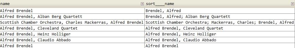

this is the issue (a query on the SQLite db)
Name in my tags are semi-colon delimited if multiple artists , AS converts them to comma delimited . Having in this case 7 line items for one Artist means that you can’t see all of his output under one Artist Icon. And this is not an isolated example its common to see 2 entries First Name first then a second LastName first.
In Classical music (and I would venture in Jazz) multiple artists is quite common, more so than in Rock
It’s not a good design IMHO
I suppose I could fix this one instance by making all Name sort = ā€˜Alfred Brendel’ but I am loathed to hack the AS db
