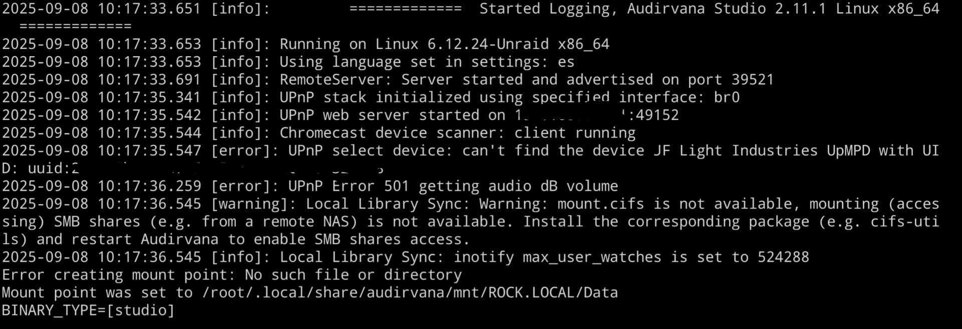

Right now, i’m on unraid (up to date) and running this docker image: lexgo/audistudio:latest. I had made the template my self, so i assume there are a lot of things bad. I have mount my Roon ROCK internal storage through host samba (so no need to mess whit this). Anyways, in general everything works quite well. Well enough to be astonished about the quality.
But, i experiencing a lot of issues with UPnP and my endpoints. The logs show a lot of threads like this:
025-09-06 22:29:40.011 [error]: UPnP audio device unreachable (powered off ?), aborting playing position monitoring
2025-09-06 22:29:40.052 [error]: UPnP select device: can’t find the device JF Light Industries UpMPD with UID: uuid:2d54c7b1-2337-5ee5-2c55-2ccf67323988
2025-09-06 22:29:41.278 [error]: UPnP Error 501 getting audio dB volume
2025-09-06 22:29:44.327 [warning]: UPnP failed to send file info for not found fileLoader for trackId 0
2025-09-06 22:29:44.428 [error]: UPnP select device: can’t find the device JF Light Industries UpMPD with UID: uuid:2d54c7b1-2337-5ee5-2c55-2ccf67323988

I had done the reboot and this is the log. Same result. (The smb error is not relevant because I have the share mounted in the host and it can be read with no issues)
This is the same log running on windows.
The difference is the message UPnP select device: can’t find the device (which is not true, because it plays music). I have left the end of the log because i constantly have this error log to.
Maybe i need to setup something i’m missing?
