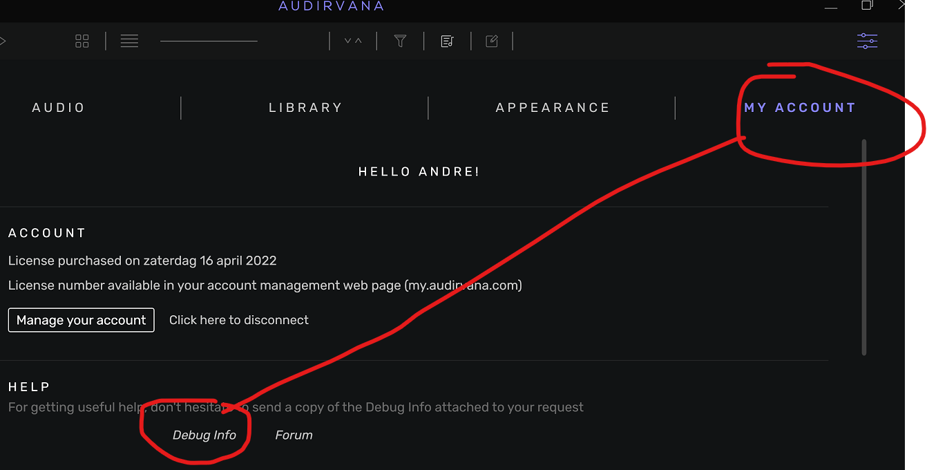

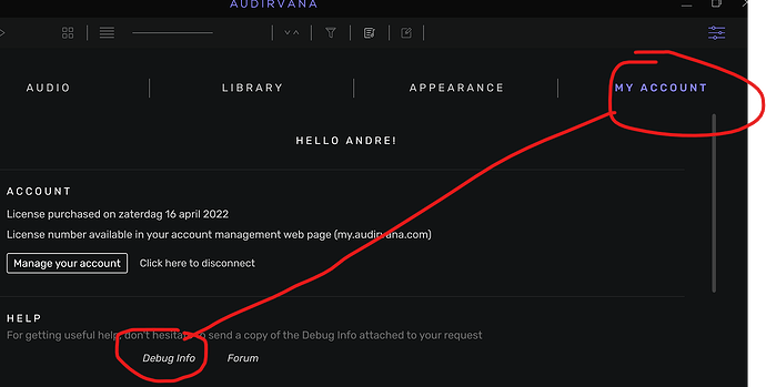

If you want to provide more info: Go to my account and click debug info. The information will be automatically copied to your clipboard and after that you can paste this info in your answer. Again if you are still using Audirvana 3.5 you will also find this in the settings somewhere:

You don’t need to know. Windows does that automatically for you.
If you copy something in Windows it automatically comes in the Windows clipboard. If you paste something after that, Windows will automatically get it from the clipboard and place it where you want.
