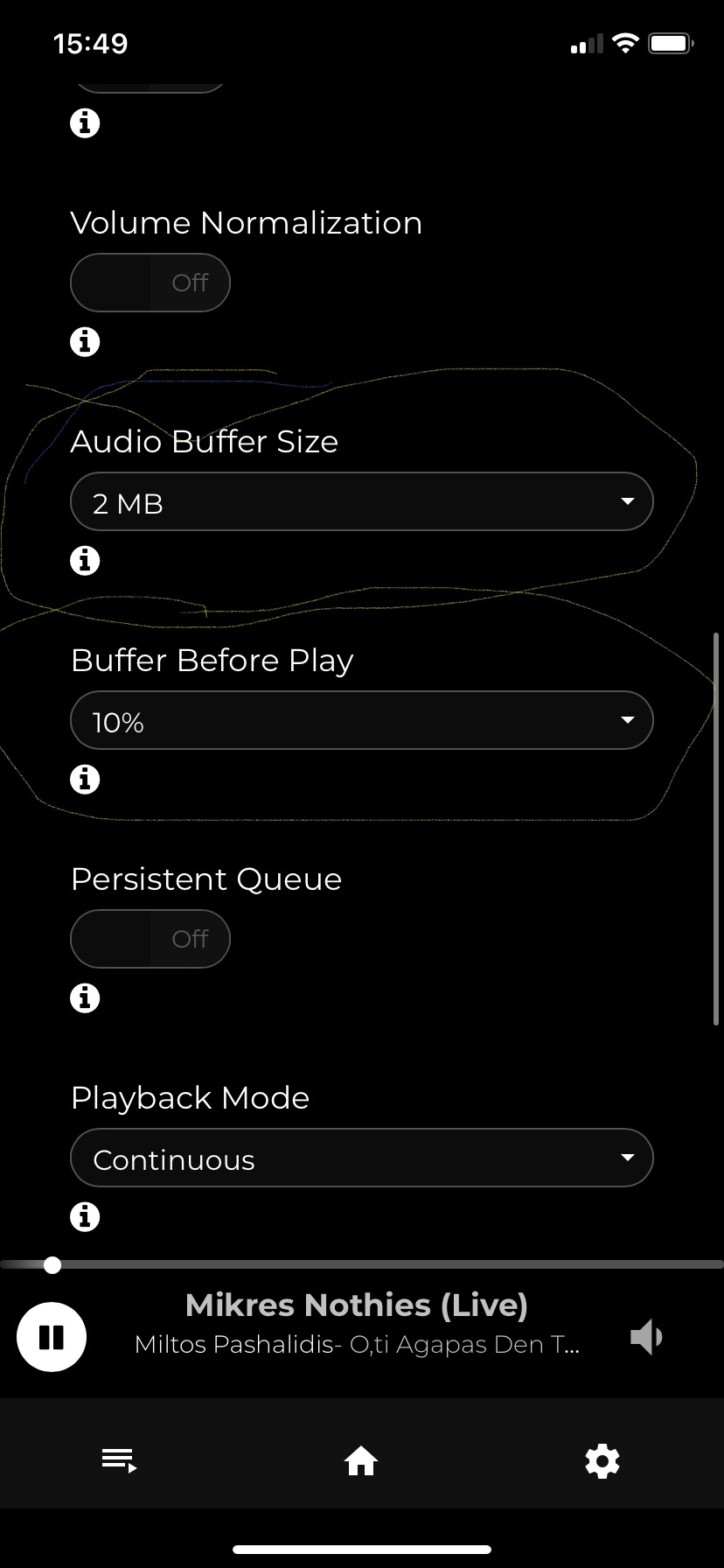

I think I found something and helped.
I made some settings to ifi streamer.
I put them in the lowest setting.
We also have a unit at the office but I won’t be able to try those settings until January 2th
Ok.
If you check it and find the best settings send me please.
Have a nice holiday.
I have 32MB as audio buffer size and 30% as buffer before play and I do not have the loading behavior you have.
If lowering those settings helped then keep them as you set them
