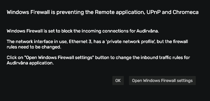

Thank you all for reporting these false positive warnings on firewall blocking Audirvāna inbound connections, especially when using a 3rd party solution like McAfee.
First, this new feature is only a diagnostic one, meant to help solving the #1 cause for Remote not connecting, UPnP, Chromecast playback not starting: inbound connections blocked. (The #2 for remote is router hang in its mDNS stack)
Getting the warning message does not hamper any Audirvāna feature, it is only a warning message.
Anyway, there was a limit to this diagnosis: some 3rd party firewalls. I’ve then made an update skipping this check when a 3rd party firewall is detected as registered in place of Windows Defender.
You can already get access to the release candidates for the upcoming 2.5.3 for Windows:
Studio 2.5.3 release candidate
Origin 2.5.3 release candidate
For those who had such false positives, please tell if this update removes the unwanted warning.
With McAfee, seeing the screenshot you’ve provided, you’ll want to switch off Net Guard for Audirvāna to get it detected by the Remote App.
Access set to ā€œIncoming and outgoingā€ and ā€œOpen to all devicesā€ is fine.
