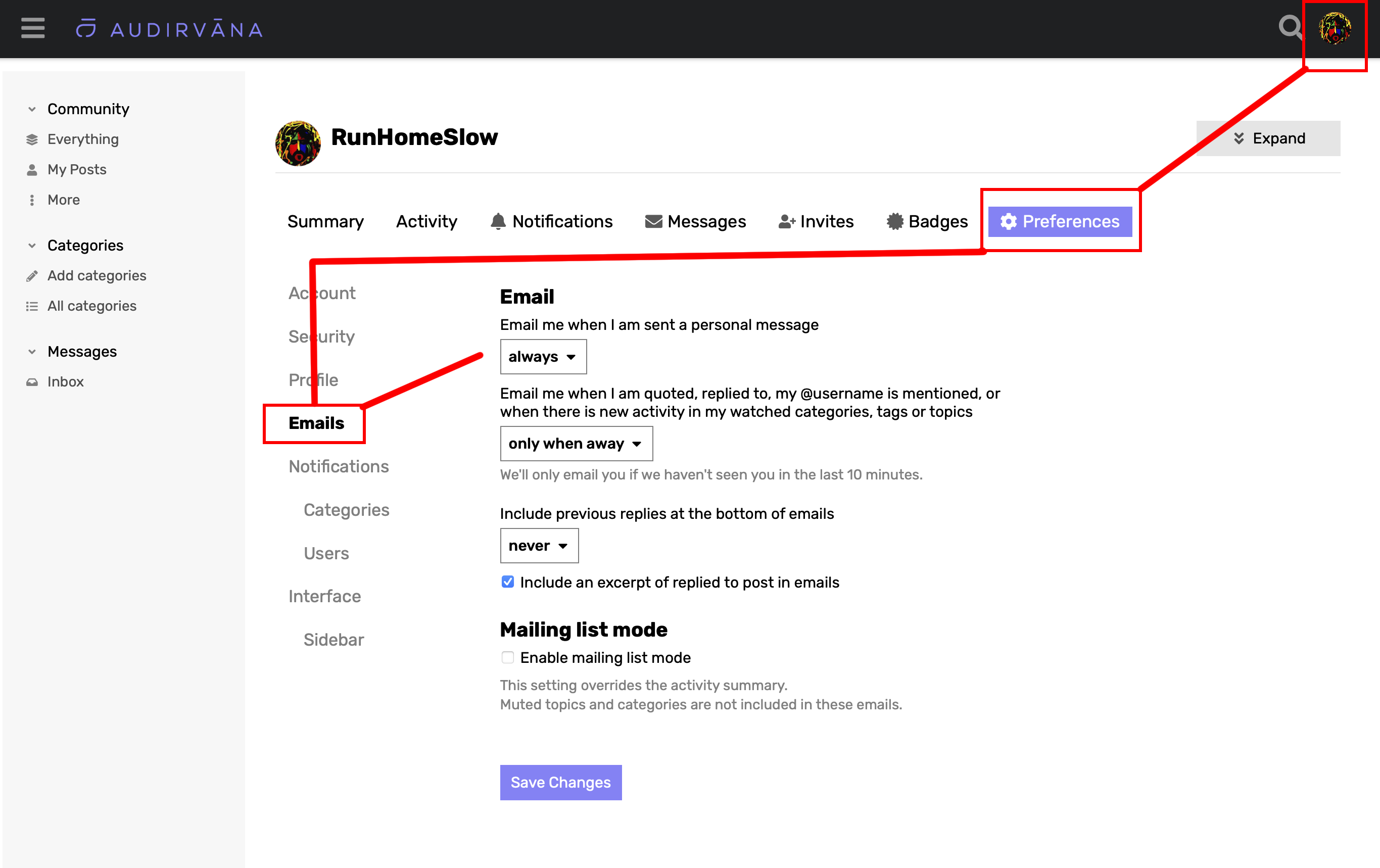

Also I did look at my preferences, it looks like my notifications are on for my email, but I’m not receiving anything. I went back through and save changes just to see if that helps.
Thanks again.
Maybe it goes into your junk folder and you will need to say to it ā€˜not junk’

After going into preferences now, my notifications are going to my junk mail so I am moving them hoping that works.

i have sent you a private message, you should see something flashing or something here…
just click anyone icon to see options… message
maybe this preference is not on for you…
