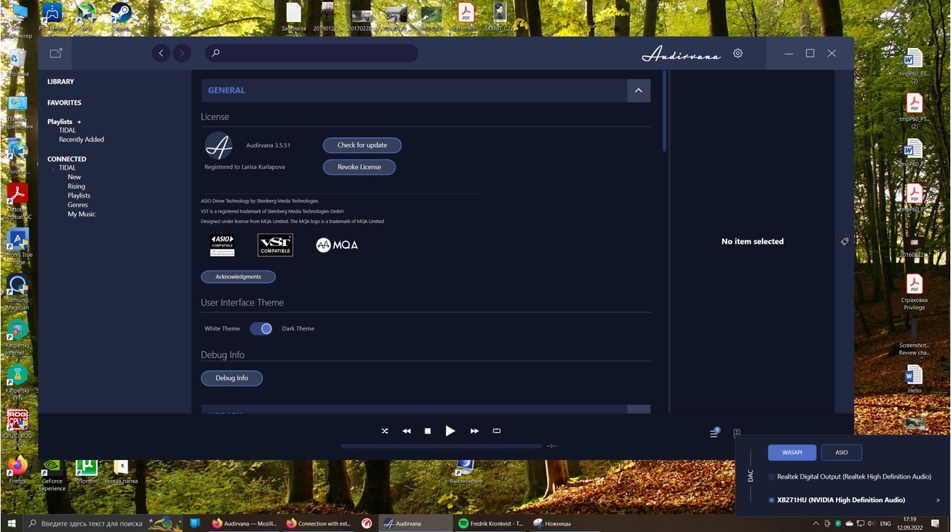

Hello, I have a problem that Audirvana 3.5.51 for Windows 10 does not see my Cambridge streamer via Ethernet. This is the first time this has happened in 3 years. So I had to install Spotify on my PC and listen through it. Spotify sees my CXN v2 streamer, so I think that the problem is in some setting of Audirvana, but I could not find anything. Please tell me in detail, as I am not an experienced user. Debug info
Audirvana Studio 3.5.51 (2051)
Windows Майкрософт Windows 10 Pro (19043) with 16GB physical RAM
SoX not in use
SoX filter parameters
Bandwidth at 0dB = 99.5
Filter max length = 30000
Anti-aliasing = 100
Phase = 66
AUTO: D:\Загрузки\Музыка
Library database path: C:\Users\Jurij\AppData\Local\Audirvana\AudirvanaPlus\AudirvanaPlusDatabaseV2.sqlite
TIDAL: Connected as HIFI
Max. memory for audio buffers: 5886MB
Local Audio Engine:WASAPI
XB271HU (NVIDIA High Definition Audio)
Model UID:XB271HU (NVIDIA High Definition Audio)
UID:\?\SWD#MMDEVAPI#{0.0.0.00000000}.{c1e79fab-6646-412c-9339-2a578f630a47}#{e6327cad-dcec-4949-ae8a-991e976a79d2}
Active Sample Rate: 48kHz
Selected device:
Local audio device
XB271HU (NVIDIA High Definition Audio) Manufacturer:
Model UID:XB271HU (NVIDIA High Definition Audio) UID:\?\SWD#MMDEVAPI#{0.0.0.00000000}.{c1e79fab-6646-412c-9339-2a578f630a47}#{e6327cad-dcec-4949-ae8a-991e976a79d2}
1 available sample rates up to 48000Hz
Not a MQA device, user set to MQA Renderer
DSD capability: Unhandled
Simple stereo device: No
Device #0: Realtek Digital Output (Realtek High Definition Audio) Manufacturer: Model UID: Realtek Digital Output (Realtek High Definition Audio) UID: \?\SWD#MMDEVAPI#{0.0.0.00000000}.{06251b9d-47cb-4a8f-8079-2e22e673ef91}#{e6327cad-dcec-4949-ae8a-991e976a79d2}
Device #1: XB271HU (NVIDIA High Definition Audio) Manufacturer: Model UID: XB271HU (NVIDIA High Definition Audio) UID: \?\SWD#MMDEVAPI#{0.0.0.00000000}.{c1e79fab-6646-412c-9339-2a578f630a47}#{e6327cad-dcec-4949-ae8a-991e976a79d2}
