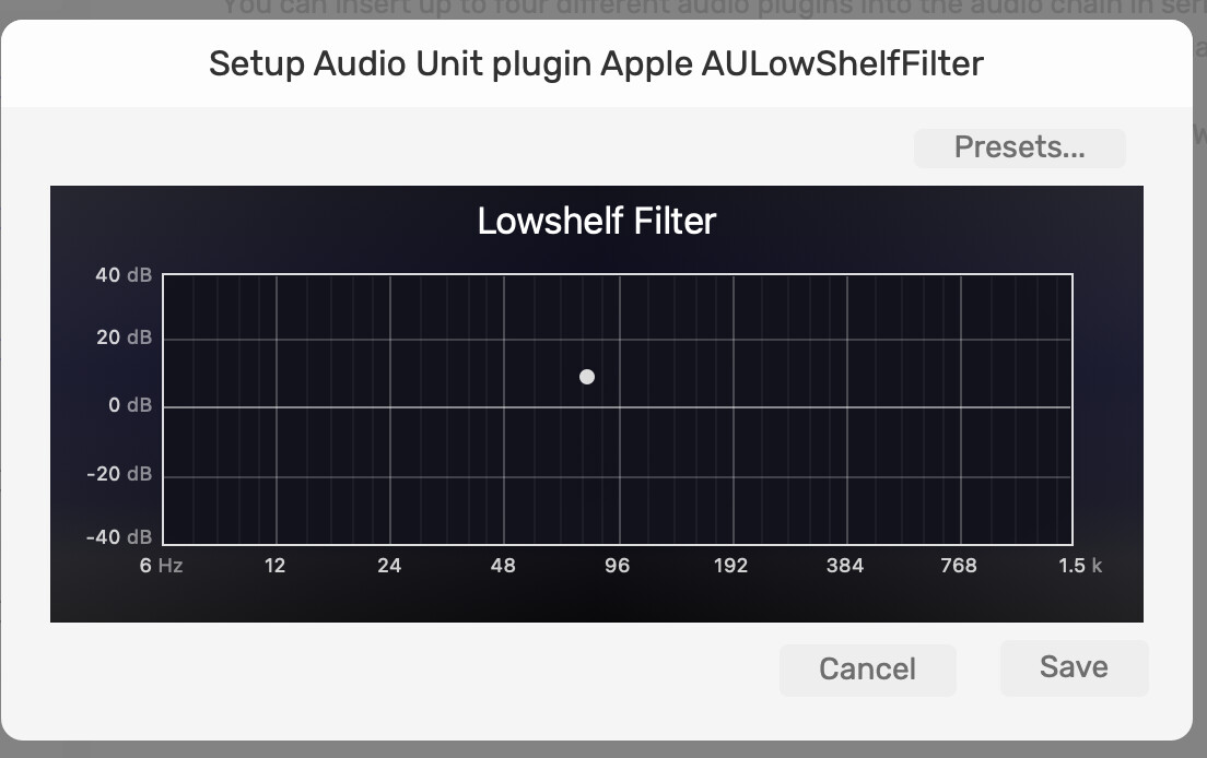

I have Magnepans 3.3. Brilliant transperant sound. A little light on bass. So I do a simple fix with a tiny increase of bass by utilising AppleeAULowShelfFilter. It’s a tiny a, teragion but seems to make the 3.3s sing.

The Frequency Response of those ProAc speakers is 55Hz – 30kHz… If you want something that digs down below that 55Hz you would need a SubWoofer others have suggested… You could also try and move the speakers/main listening position as others have suggested… You could also try boosting with EQ as others have suggested… Audirvana Studio now has built in EQ so you could try the boosting without much effort… Typically boosting the low frequencies much beyond +3db will get you distortion… I chose to add an active subwoofer to my kit as my speakers only go down to 42Hz… And yes there are some musical instruments that dig down that low…
