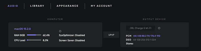

Here are some print screens and the log.

It looks to me that with UPnP the JBL’s support higher resolutions. 44.1 kHz and above. So true hi-res. If that connection is stable then I would be using that over AirPlay.
The numbers which are marked in blue are supported resolutions. In your case PCM up to 192 kHz.
My WiiM Ultra for example supports PCM up to 192 kHz and DSD up to 128.

That is correct. This is what Audirvana plays to my WiiM at the moment. I’m feeding the WiiM into the Loxjie which produces the sound. 24/192 FLAC file that plays as a 24/192. It doesn’t get downsampled like what happens when you are using AirPlay.
