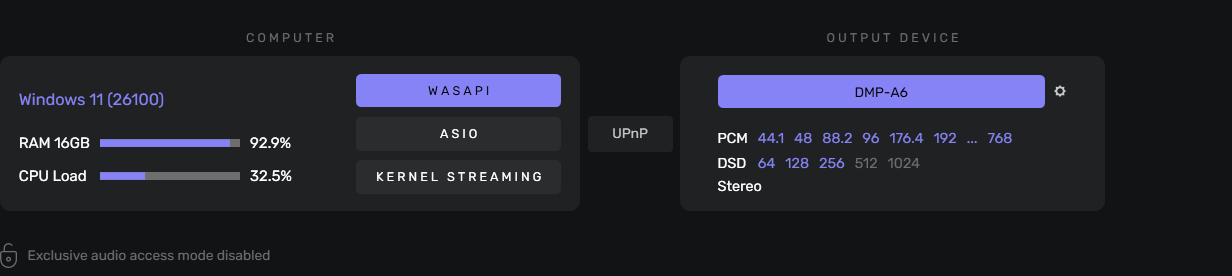

Hi I have been using Roon for a while and intend to move to Audirvana and is currently on Trial. I have good collection of DSD files. However these files do play but no audio comes out of speaker.
I have selected Native DSD Streaming Method : DSD over Native PCM 1.1
Will appreciate any thoughts on this

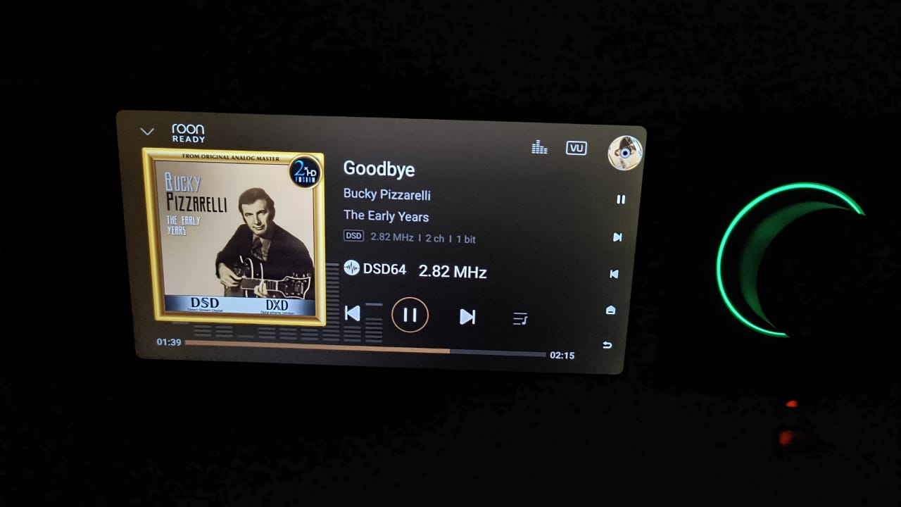

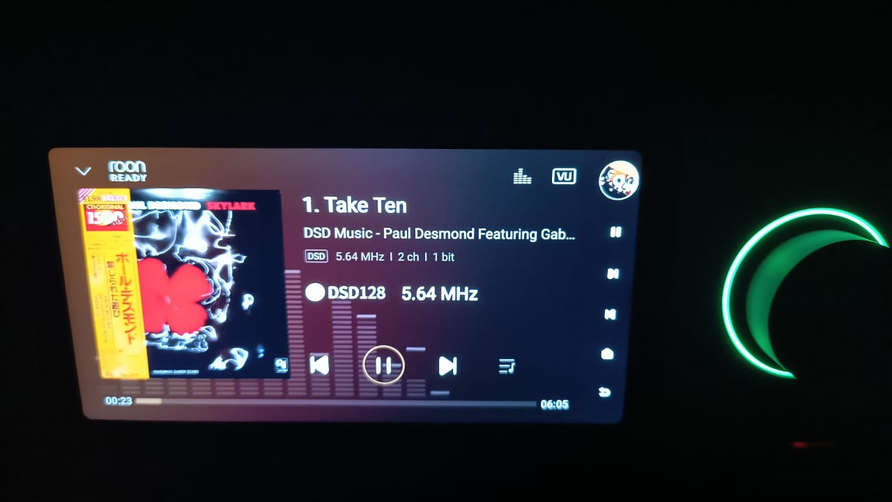

Thanks, But Roon does play DSD File Natively . Please check the Image attached

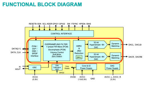

ESS ES9038Q2M
It should play as roon with dsd over pcm 1.1
It must be a setting in Audirvana with volume on your machine or dac… is it set to 100%
Ain’t that a thing with dsd files volume as to be set at 100% or something like it?
Lets say that I am :grinning: not a technical person, this block diagram for me is Rocket Science

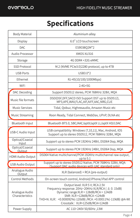

It does not appear from the User Manual, that the DMPA6 supports DSD over PCM (DoP) via USB or Ethernet … Otherwise we need the debug report in-order to see the DAC capabilities… The screenshot above is showing only, that it is playing a DSD128 file and the OP states that it is playing it natively…
Here is a screenshot from the DMPA6 Manual:

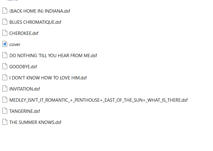

It appears that the DSD files you are trying to play are .DIFF format… Audirvāna supports .DFF files via UPnP … Also, the DMPA6 does not support .DIFF files.
From the UPnP troubleshooting link I provided above:
DSD playback doesn’t work
When playing to a UPNP device capable of supporting DSD with Audirvāna, the device must state it supports DFF. This information is available once your device is selected as an audio output in Audirvāna and going on the debug info. You can get it in Audirvana Settings>My account.
  • If you see this line: http-get::audio/dff: under the section UPnP / DLNA supported protocols, your device supports DFF over UPNP.
So this line is not there. But the same DSD File does play Via ROON. The files.dsf
