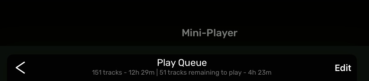

In the remote app on iPad we get the details of both the Total No of Tracks in Play Queue and how many remain to be played… however;
In the Studio App on Big Screen we only get the the number of remaining tracks. In that space above the number, would you be able to include the remaining playing time.
It may seem very minor and a petty request, and it probably is :joy:, however I find that it’s just one of those little things that I really notice and use a lot when setting up play queues or adding to them.
Thanks in advance for consideration.
