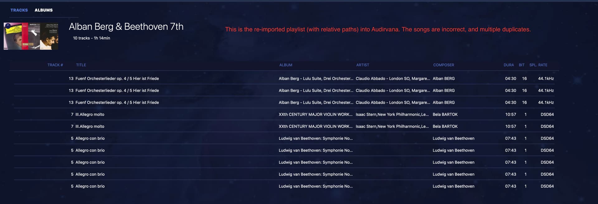

I just re-exported everything with relative paths and imported them into Eversolo.
While it does seem to play from the SSD , the playlists don’t seem to be correct.
This previously occurred when exporting playlists from Audirvāna, and then later adding them back to Audirvāna. Songs in the playlist were changed, songs were repeated.
Not sure I pinpointed the issue, but I have a suspicion it has to do with tracks in .iso files not being imported correctly from the m3u playlists.
So in a sense, the results in getting in Eversolo seems to be consistent with what happened in Audirvāna. (I had a previous post about it on these forums).

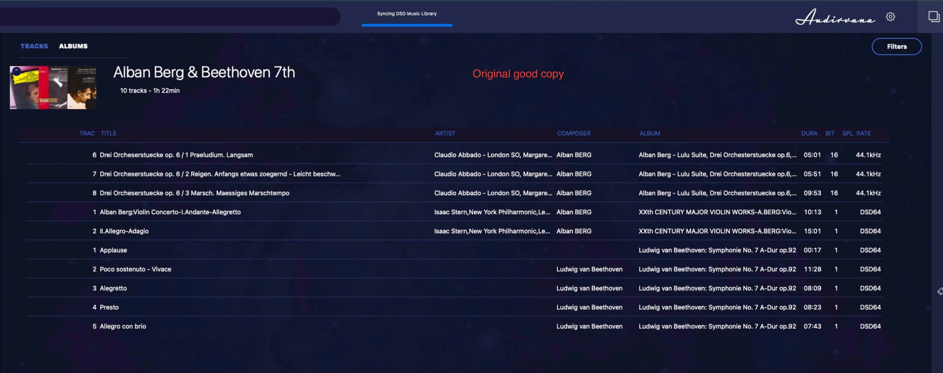

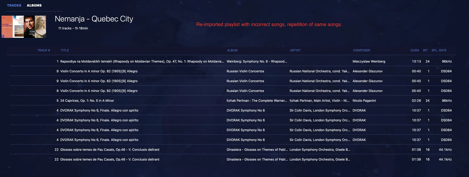

For troubleshooting purposes, I installed a copy of Audirvana on a different computer, and exported the playlist from one Audirvana, and imported to the new one. We can see how the playlist isn’t the same (both libraries are synching with the same folder on the same HDD).
I have included example of playlist #1 original and re-imported, and playlist #2 original and re-imported to show how it gets changed! So obviously when importing to Eversolo, the incorrect songs are also being imported. Relative paths doesn’t seem to correct the issue.

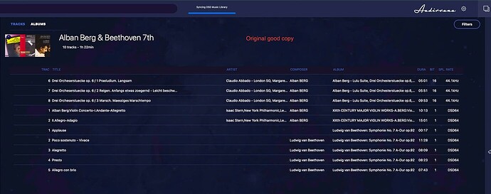

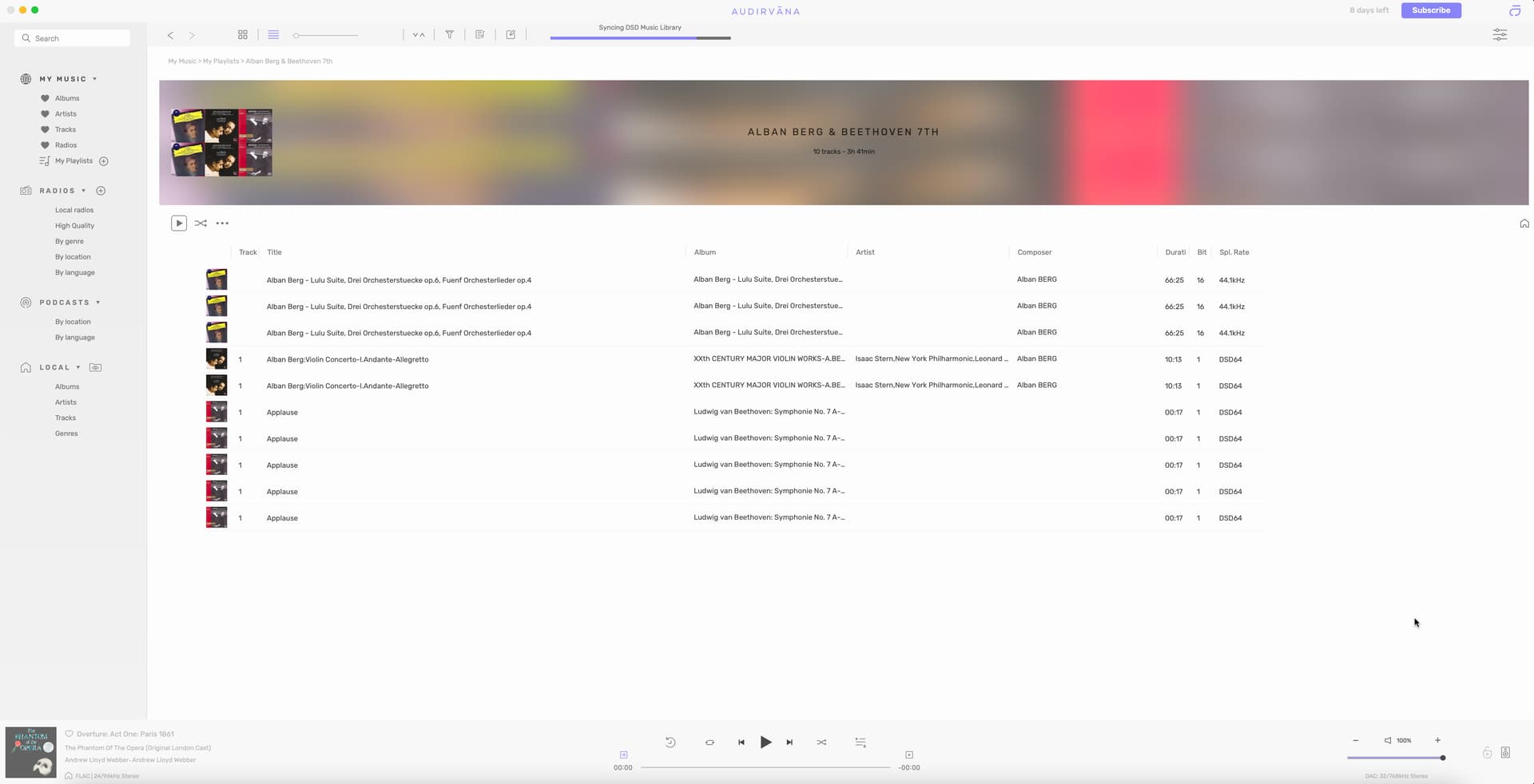

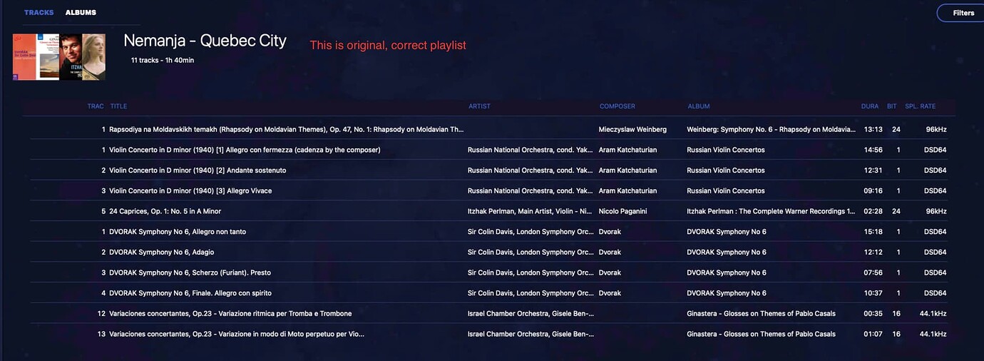

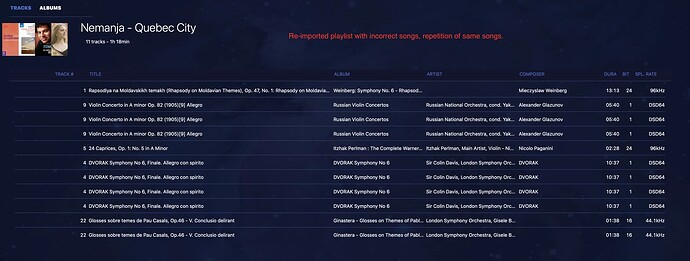

So the playlists I exported from Audirvana 3.5.50 don’t import correctly into Audirvana Studio (2.11.0) either. (same kind of behaviour when importing them into eversolo streamer)
I’ve attached the screenshots from 3.5.50 (which display correctly), and studio (which are incorrect, same as the eversolo). I also am including the text of the .m3u
So not sure where the problem is, 3.5.50 exporting incorrectly to the .m3u file? Or studio and eversolo not importing correctly?
Alban Berg & Beethoven 7th.m3u
#EXTINF:301,Drei Orcheserstuecke op. 6 / 1 Praeludium. Langsam
…/DSD Music Library/Alban Berg - Lulu Suite, 3 Orchesterstuecke op.6, 5 Orchesterlieder op.4 (Abbado; Price)/Alban Berg - Lulu Suite, Drei Orchesterstuecke op.6, Fuenf Orchesterlieder op.4.ape
#EXTINF:351,Drei Orcheserstuecke op. 6 / 2 Reigen. Anfangs etwas zoegernd - Leicht beschw…
#EXTINF:593,Drei Orcheserstuecke op. 6 / 3 Marsch. Maessiges Marschtempo
#EXTINF:613,Alban Berg:Violin Concerto-I.Andante-Allegretto
…/DSD Music Library/Alban Berg & BelĆ” Bartók - Violin Concertos - Isaac Stern - New York Philharmonic - Leonard Bernstein/Isaac Stern - New York Philharmonic - Leonard Bernstein - Alban Berg & BelĆ” Bartók - Violin Concertos.iso
#EXTINF:901,II.Allegro-Adagio
#EXTINF:17,Applause
…/DSD Music Library/Carlos Kleiber - LV Beethoven Sym 7 A-Dur op.92_iso/Carlos Kleiber - LV Beethoven Sym 7 A-Dur op.92.iso
#EXTINF:688,Poco sostenuto - Vivace
#EXTINF:489,Alegretto
#EXTINF:503,Presto
#EXTINF:463,Allegro con brio

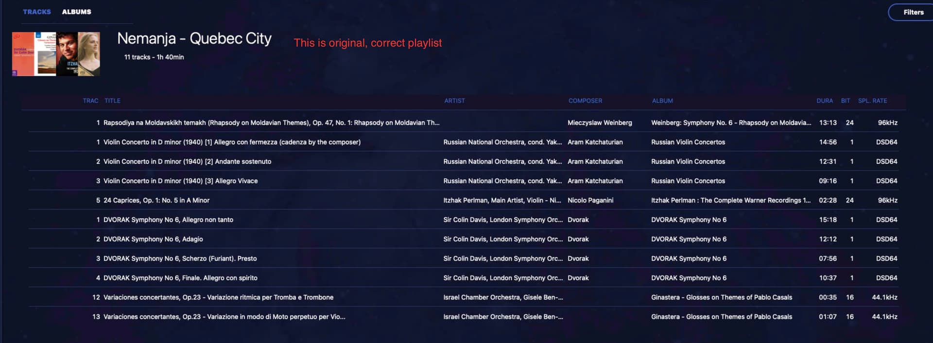

Nemanja - Quebec City.m3u
#EXTINF:793,Rapsodiya na Moldavskikh temakh (Rhapsody on Moldavian Themes), Op. 47, No. 1: Rhapsody on Moldavian Themes, Op. 47, No. 1
…/DSD Music Library/Weinberg - Symphony No. 6, Rhapsody on Moldavian Themes - Vladimir Lande (2012) [24-96]/01. Rapsodiya na Moldavskikh temakh (Rhapsody on Moldavian Themes), Op. 47, No. 1 Rhapsody on Moldavian Themes, Op. 47, No. 1.flac
#EXTINF:896,Violin Concerto in D minor (1940) [1] Allegro con fermezza (cadenza by the composer)
…/DSD Music Library/Khachaturian, Prokofiev, Glazunov - Russian NO, Yakov Kreizberg, Julia Fischer/Julia Fischer - Russian Violin Concertos.iso
#EXTINF:751,Violin Concerto in D minor (1940) [2] Andante sostenuto
#EXTINF:556,Violin Concerto in D minor (1940) [3] Allegro Vivace
#EXTINF:148,24 Caprices, Op. 1: No. 5 in A Minor
…/DSD Music Library/Perlman - Paganini - 24 Caprices (24-96, 2015)/05-24_Caprices_Op_1_No_5_in_A_Minor-SMR.flac
#EXTINF:918,DVORAK Symphony No 6, Allegro non tanto
…/DSD Music Library/DVORAK Symphony No 6 - Sir Colin Davis, LSO [SACD ISO]/Sir Colin Davis, London Symphony Orchestra - DVORAK Symphony No 6.iso
#EXTINF:732,DVORAK Symphony No 6, Adagio
#EXTINF:476,DVORAK Symphony No 6, Scherzo (Furiant). Presto
#EXTINF:637,DVORAK Symphony No 6, Finale. Allegro con spirito
#EXTINF:35,Variaciones concertantes, Op.23 - Variazione ritmica per Tromba e Trombone
…/DSD Music Library/Ginastera - Glosses on Themes of Pablo Casals/Ginastera - Glosses on Themes of Pablo Casals.flac
#EXTINF:67,Variaciones concertantes, Op.23 - Variazione in modo di Moto perpetuo per Vio…
It seems to be related to ISO files. I have been able to reproduce the issue, will look at this with Damien.

But doesn’t seem limited to ISO files. If you look at the flac files on the playlist (imported) then you can see repeats too. On the original, all the tracks are different.
