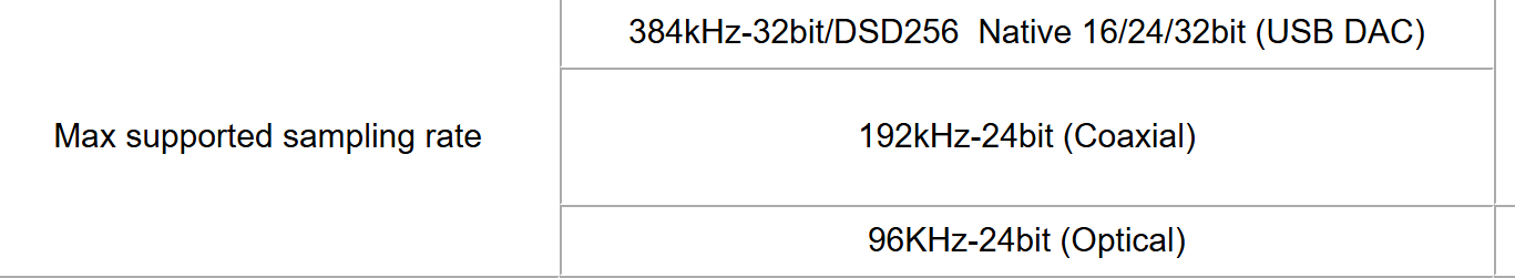

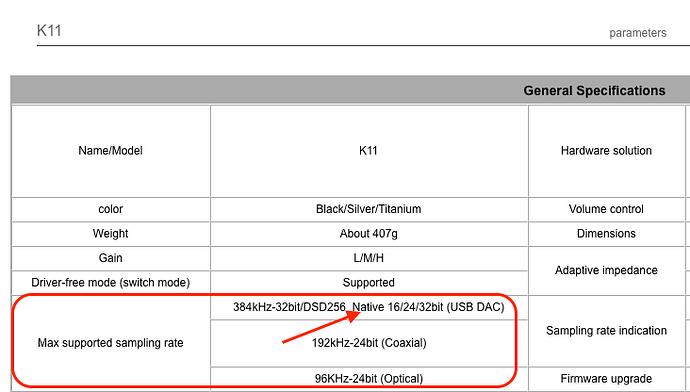

K11_parameters
For the K11 the max DSD sampling rate over USB is DSD256. The max DSD sampling rate you can play via your MacBook here is DSD128 which is also correctly reported by Audirvana.

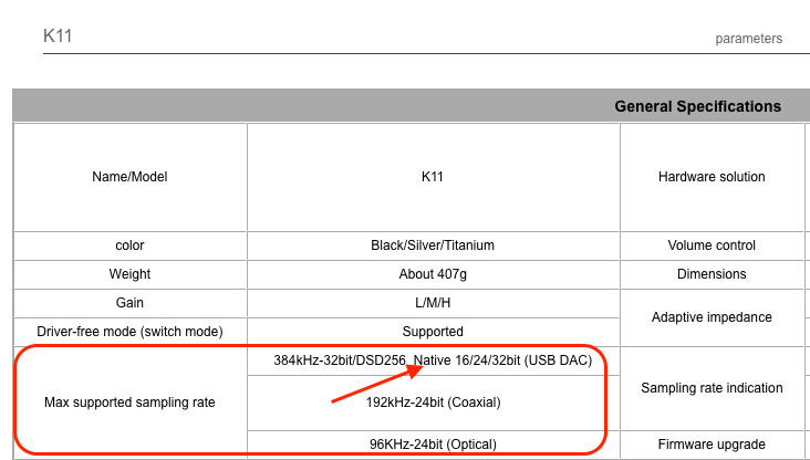

The K11 supports PCM sample-rates to 384/kHz…
The DSD over PCM (DoP) PCM carrier sample-rate for 1-bit 11.2MHz PDM (DSD256) is 24/705.6kHzYou will not be able to play DSD256 files via DoP 1.1 via USB.
Because the K11 supports DSD256 native
The only way to play DSD256 files on your MacBook and K11 is to use an Ethernet connection and send the files natively via UPnP to a streamer that supports the DSD .DFF file format… However you will be able to play 1-bit PDM 5.6MHz (DSD128) files via DoP 1.1 USB, because the DoP PCM carrier sample-rate is 24/352.8kHz.
