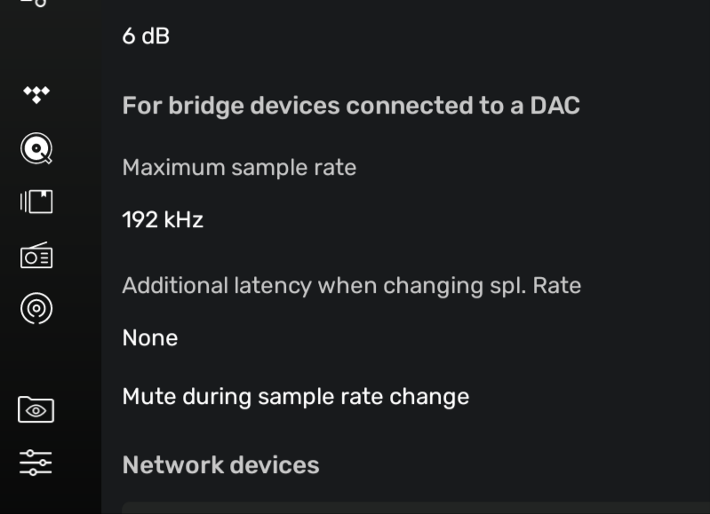

The thing is that I most often experience crackling when I select different tracks on my own that differ in sampling. I listen to songs this way when I test some equipment or cables, which happens quite often lately. There is never any crackling below 192 kHz. When I play an album with this sampling there is no crackling between tracks either. Very rarely, even occasionally, there are crackles when I listen to the playlist and the tracks have different samplings. Again, if the crackles occur, it is only with the 192 kHz track. I have SoX off and DAC is in NOS mode. Streamer and DAC are connected via I2s cable. To test, I switched to the SPDIF cable and the problem was similar. I also tried playing from PC via USB cable directly to the DAC, bypassing the streamer. Then the problem didn’t occur at all. I tested the Gustard x30 DAC with an I2s cable and the problem was identical to that with my streamer.
Maybe you have some new thoughts?
Make sure your I²S cable pin configurations are correct for the device(s)
It could be so, but there are two facts that contradict this: firstly, it has not been like this from new, it only happened some time ago, and secondly, crackling noises also occur via SPDIF.
My many years of experience working with computers have taught me that if something occurs sporadically, it is more likely a hardware problem than a software problem. Unfortunately, when a defect occurs so sporadically, sending it to service seems to make little sense.
@Jacek Try limiting the bit-depth to 24bit and lower your Audirvāna output gain -6dB to see if this gives you a working baseline playback scenario.
@Agoldnear You mean to turn down the volume in Software Volume Control?
Note that I only use Remote because I have a headless system.
I have it limited to 24 bits.
Will enabling Preserve Album Dynamics have any impact?
Yes… the Audirvāna Volume control… experiment with Volume Leveling…
No, it has no influence on it.
By the way, it turned out that when is the same set of two songs and the first has a low bitrate and the second has a higher bitrate, there are crackling noises when switching manually and when first ends and the next one begins after it, there are no crackles.
I mentioned that this has been happening for some time, I wonder if it is caused by a newer version of Audirvana or an update in GentooPlayer?
Was that for me? If so, I don’t use DSD.
Ahh… Okay…
So it seems you should get a working baseline performance using direct USB transmission from your computer to your DAC and work from there…
…at the expense of quality, unfortunately.
I think I’ll stick with what I have, at most, I won’t choose songs selectively.
Then more-likely-than-not this is related to the 4GB of System RAM available, when tracks are loading in the background during playback… You are allocating 2.3GB for playback preload memory, and running Audirvāna at the bare minimum System requirements… More System RAM is better…
