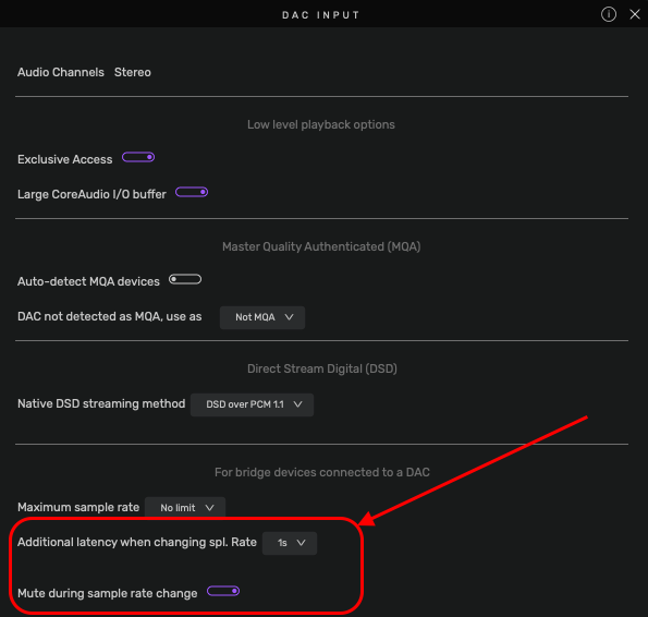

These are the relevant controls…
“Pop” goes DSD? Why does this happen?
Dear Agoldnear,
I used this function. Up to 3 seconds. No positive result.

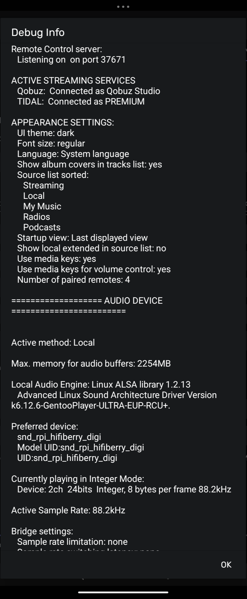

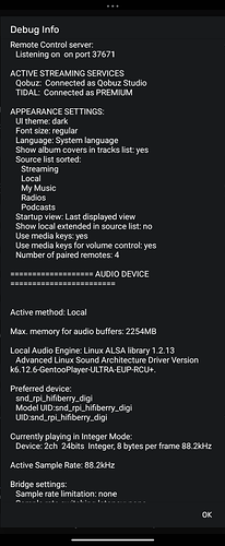

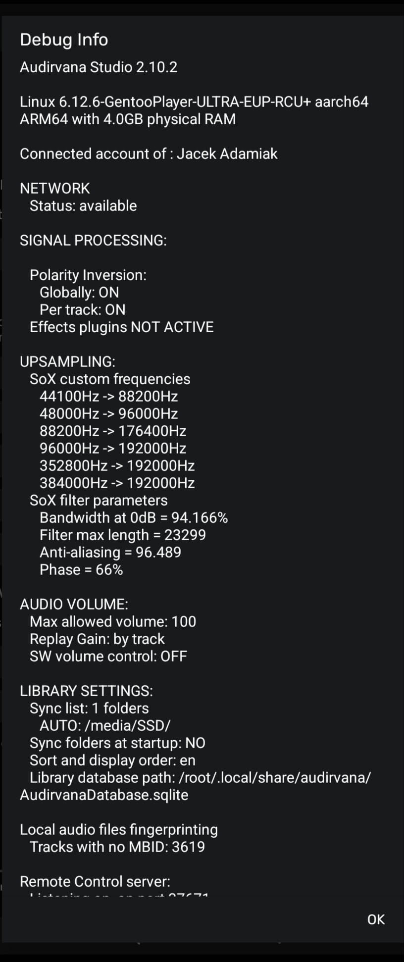

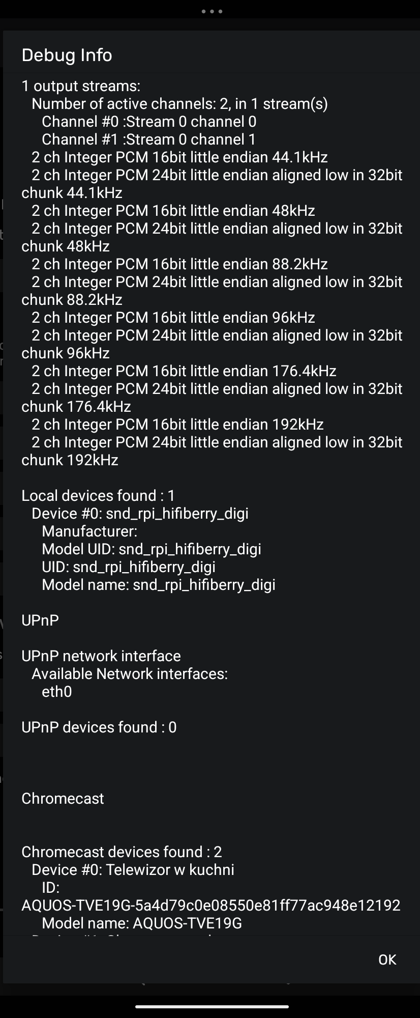

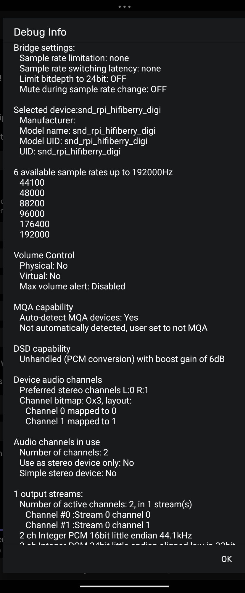

Unfortunately, on my Lenovo tablet Debug copy function is not possible.
I can only post a few screenshots.
I also wonder if it could be an issue with the sound card driver that Audirvana Studio sees. In AS there is snd_rpi_hifiberry_digi and in GentooPlayer in the DAC section HiFiBerry Digi+ Pro is selected.

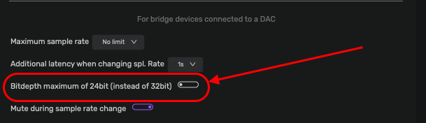

Your DAC supports up to 24 bit files… I suggest limiting the bit-depth to 24 bits… Also if you are finding that you get these anomalies when playing 352.8kHz and 384kHz files, you must remember that you are decimating these sample-rates to 24/192kHz and in the process may be getting round-off error noise. I suggest you change your custom sample-rate conversion for 352.8kHz files to 176.4kHz the logically correct result, rather than 192kHz.
The behavior you are experiencing may be related to the available system RAM… It appears that you are using 2.3GB of your 4GB of System RAM for playback pre-load memory… try lowering this to 500MB… the recommended available System RAM for Audirivana on Linux is 2GB where the bare minimum is 1GB… The axiom for flawless digital-audio playback is this: “More System RAM is better…”
I’m not really sure where to change the 32-bit to 24-bit setting. Mano streamer can passively transfer the signal up to 24/192 kHz. Therefore, a higher signal should not reach the DAC.

I’m also wondering whether to introduce a latency when changing the sample rate.
