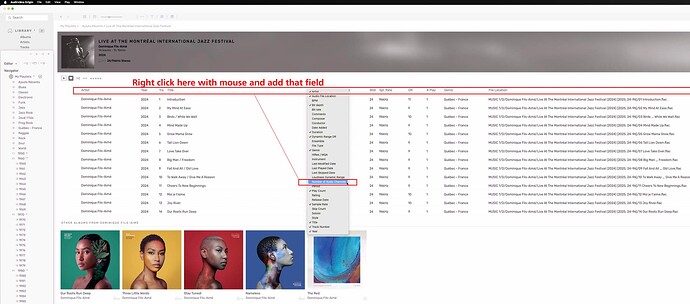

If you put that field in your album window… Numbers of audio Channels…
can you see the 2 Channels and/or the 5/6/7 Channels and can only play what you want??
i don’t have .iso files
