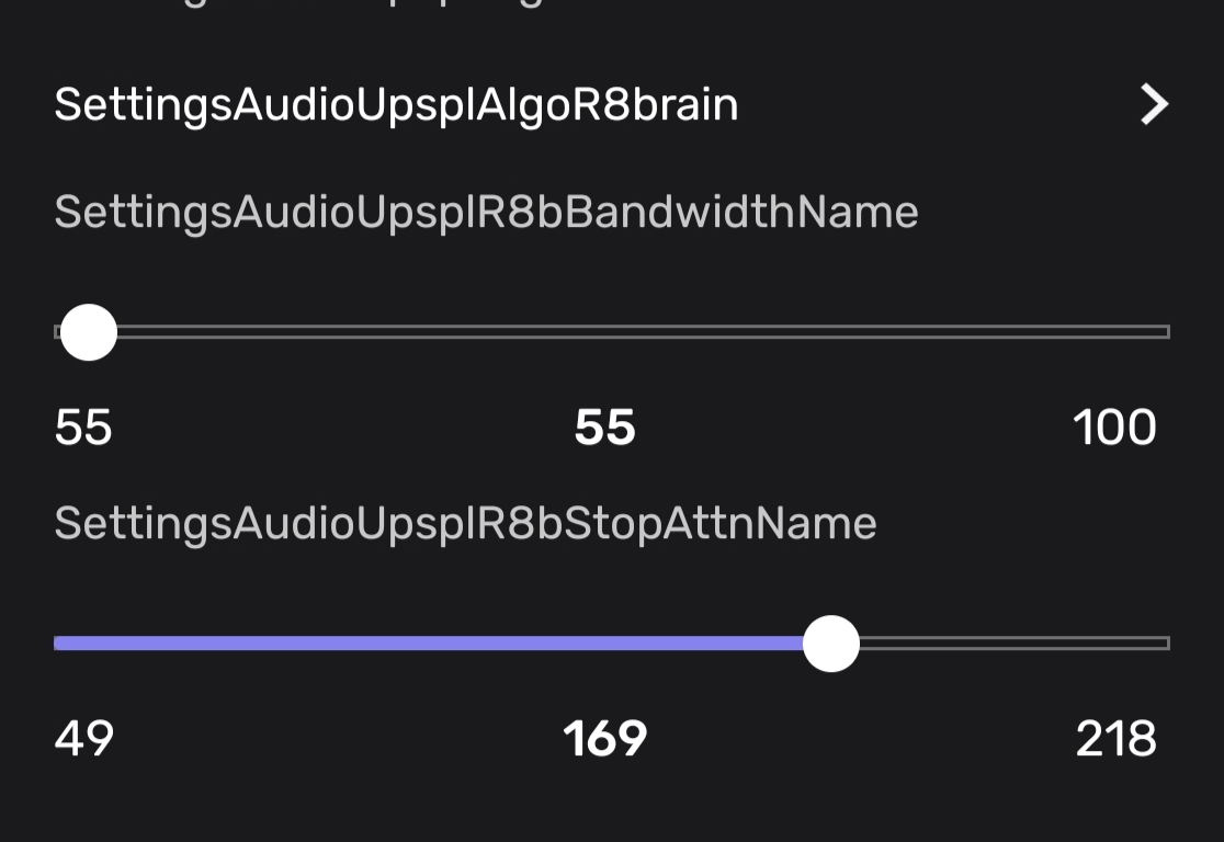

I am using audirvana on linux and remote app on Android. When i go change upsampling settings on remoteapp, they are automatically changed back to default. How do i fix this?

Yes. To be more specific with my problem. I can change between r8brain and sox and between upsampling types. But i can’t change example r8brain bandwidth from 55 to 75 or any other slider.

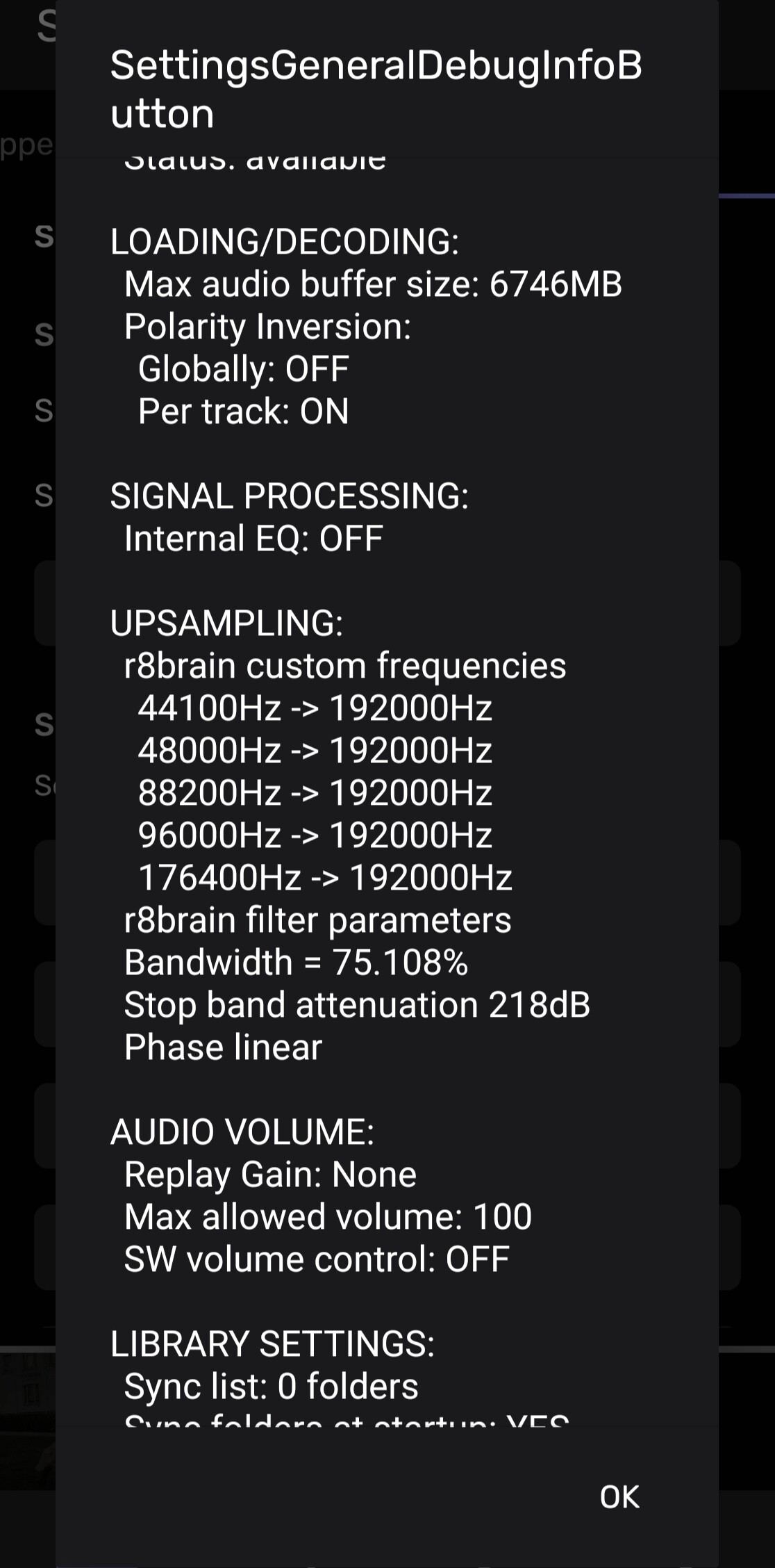

Hmm, I see something strange there. Can you send us a copy of the "Debug Infoā€œ when you have this issue? You can get it in Audirvana Settings>My account.
debug info shows it at 75 even though the slider will reset itself to 55.
I can’t copy the text for some reason but here is photo where you can see that it shows bandwidth at 75.

Hi, @BotWaldo and @Antoine . I have this same issue. Audirvāna does follow the latest adjustment in practice. It just doesn’t show on the screen after that. With checking debug info I noticed that it is adjusted nonetheless.
Hi guys, this is a known issue I have brought to our dev some time ago, I’m still waiting for a fix for it.
I’m very sorry about this.
