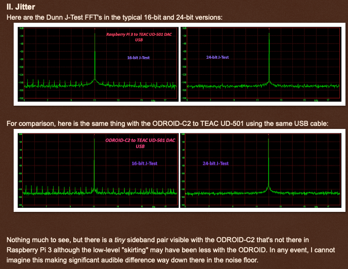

Archimago measured the output of a simple Raspberry Pi 3 feeding a USB DAC and foubd it to be clean! See

To me the measurements look fine. But perhaps you see more into the data than me.
From the article:
ā€œAs usual, what is important is to check the analogue output of the DAC and make sure there’s no evidence of excess noise or distortion. Also, we’ll have a look at the jitter test measurements.ā€
Measuring on the analog output port of the DAC says absolutely nothing about the quality of the USB output of any connected device. It tells you how good the DAC is at eliminating noise.
Also, the measurements done (in the table) tell you nothing about the digital output, it only tells you something about the TEAC UD-501 analogue output. That’s measured.
The jitter test is not specified how it is performed.
I bet with 100% confidence that when you swap out the used 5V SMPS that powers the Pi and the Odroid for, let’s say, a LHY 25VA of 5V and you measure again, the measurements won’t show any difference, but you will hear a difference.
The method used is simply not correct, and thus the article has no value, unless you are interested in the TEAC UD-501.
The Dunn J-Test
Apparently the measurements do tell you about the digital output… It is plainly evident in the J-Test comparisons, although it is questionable that these differences are audible in the final audition.
An audio-centric SMPS generally will perform better than a generic LPS in any given digital-audio implementation… This has been shown to be true by Benchmark Media and other DACs and power amplifiers.
Obviously, intrinsic noise in a platform design architecture must be taken into consideration… Yes, ultimately it is the analog output that we audition and assess regarding the aesthetic sound-quality. The only true digital-audio ā€œbitsā€ are those encoded on or in the storage media before being read and lifted from the storage media for transmission through the amalgamation of analog electronics topologies, to the D/A circuitry and subsequently the amplifiers and transducers that propagate that energy into the psychoacoustic domain.
The referenced article sheds light on the subject of ā€˜noise’ on the digital-audio signal (jitter) as it may influence the audible perception of sound-quality in the real-world, using a common reference…
