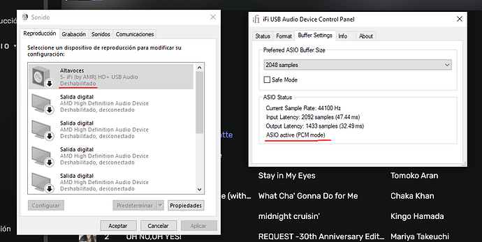

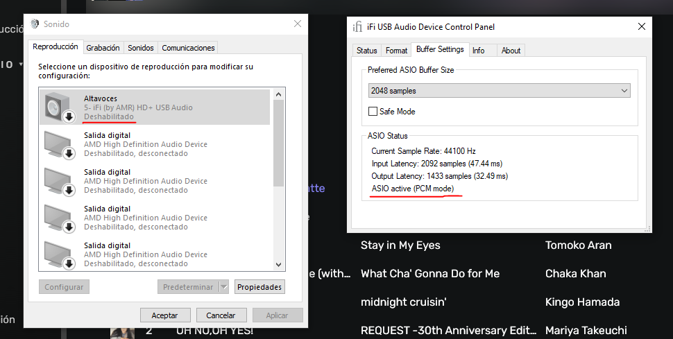

Hey everyone, just a quick update! I found that disabling the Windows audio device for my DAC/amp improved ASIO performance significantly. Before doing this, I noticed that the sound quality would change depending on Windows’ audio settings. By disabling the device, ASIO now takes full control, delivering better sound without any interference from Windows settings. Now, my PC only recognizes the DAC through the ASIO driver, ensuring a pure audio signal.
Obviously, this means you can’t use WASAPI or Kernel Streaming, it’s like not having a sound card at all.

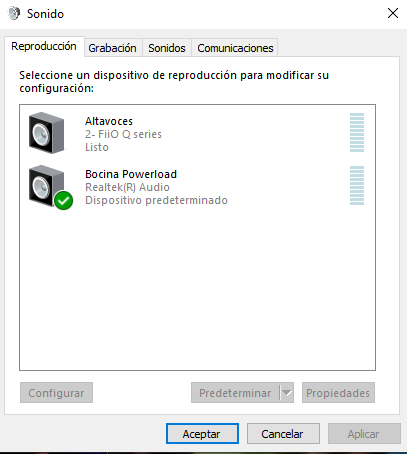

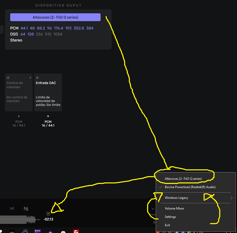

It seems like the best way to optimize the audio chain on Windows when using an XMOS-based DAC is to remove the DAC as the default audio device in Windows when entering exclusive mode. To do this, all you need is a secondary audio device (something other than your DAC) and the EarTrumpet app to easily manage and switch between audio devices.
With this setup, you use EarTrumpetto select a non-DAC audio device for general system output, while in Audirvana you still select your DAC as the output device.

  • Disabling the DAC in Windows (using it via ASIO only… this had been the best option until I discovered the method above, since you could forget about sample rate mismatches and solve the main topic of this thread. However, with this new solution, you can forget about that too and sounds better in my opinion).
