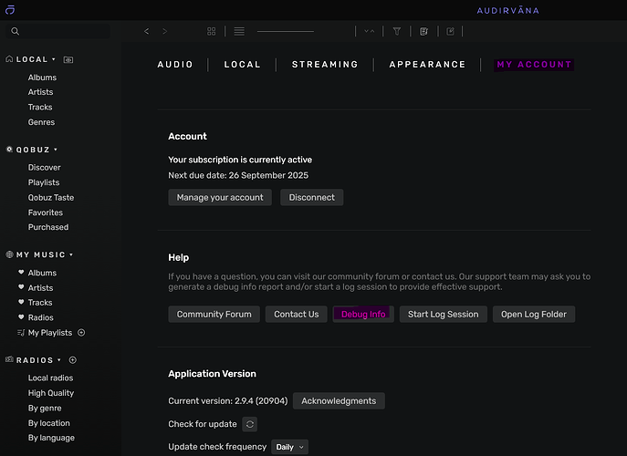

Please paste your debug information report here in this thread, so folks can help the best possible… It is found here… Settings–> My Account–> Help–> Debug info

The thread of “Settings → My Account → Help → Debug info” does not exist in the Roon desktop version. In fact, you can’t even go to the second step as My Account only leads to billing information, etc. and no link to Help.

I believe @Agoldnear is referring to the debug info in Audirvana, as opposed to Roon.
