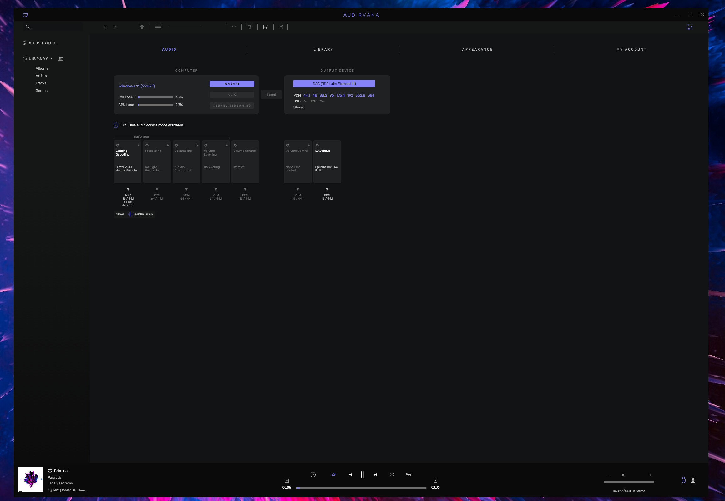

Wasapi with software volume disabled

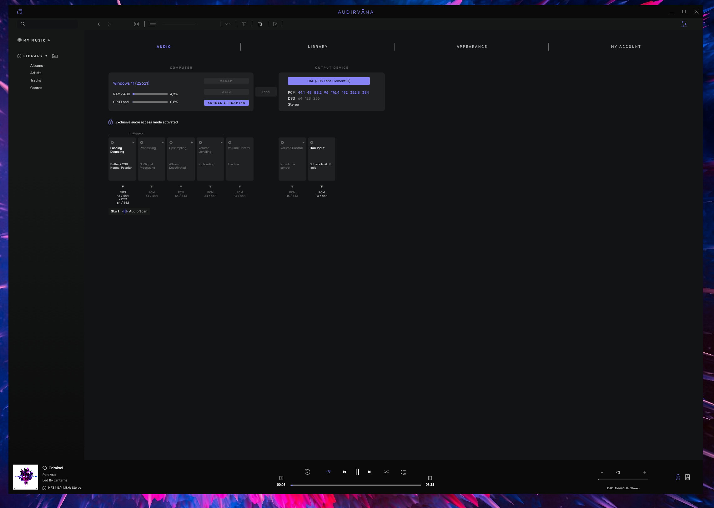

Wasapi with software volume enabled

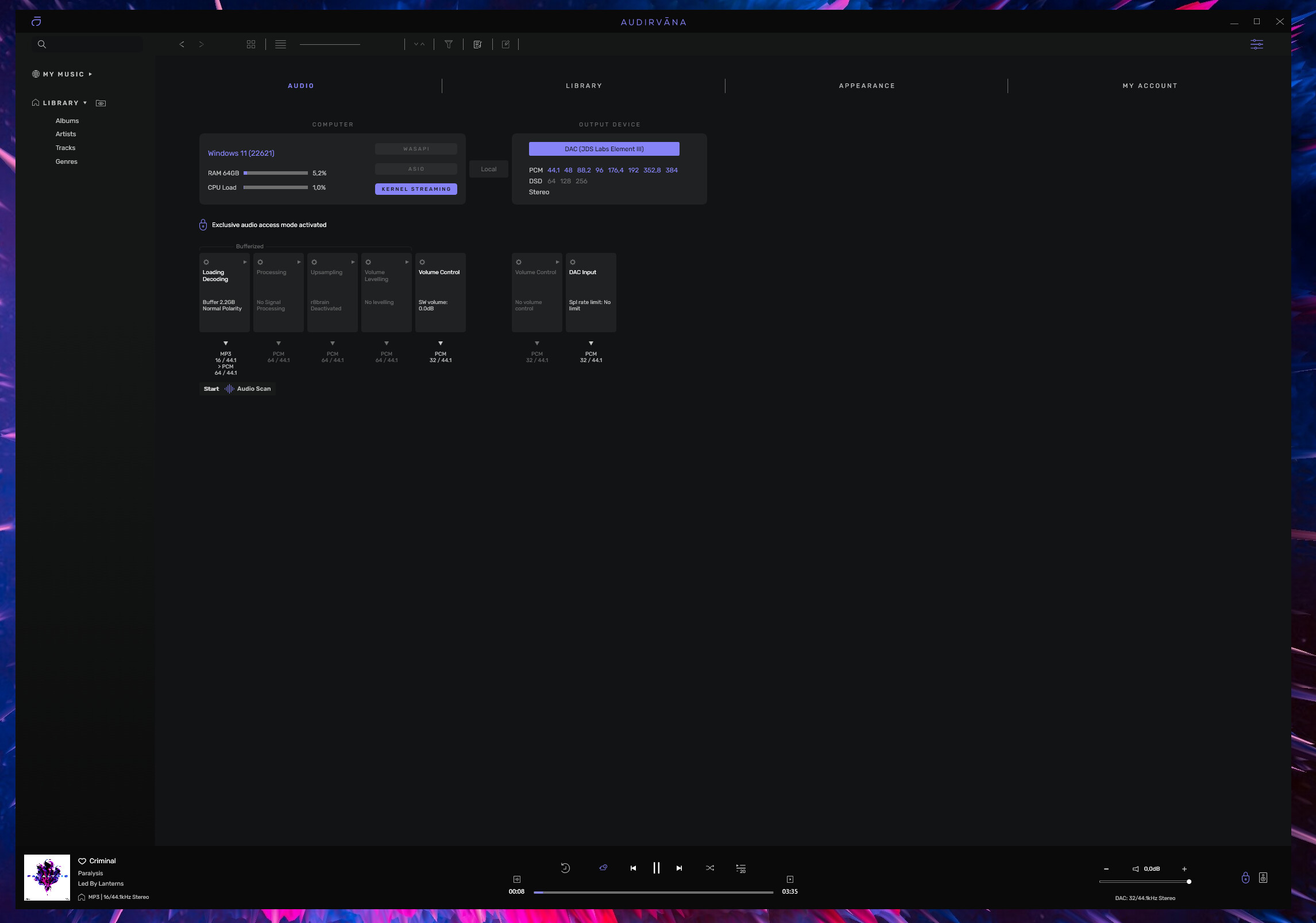

Kernel with software volume disabled

wasapi and kernel when the software volume is off change the bitrate for example if the file is 24/96 will see 24/96 at the right bottom corner too the asio is stuck at 32bit i bealive cause of the driver

indeed! but i was testing the wasapi and kernel behavior, at jds dac the wasapi and kernel when i use software volume the bitrate stuck to 32bit when i disable the software volume goes to 16 and adapts to the file bitrate.
the fiio dac i test works correctly with enabled and disable the software volume shows 16 and adapts to the file bitrate
on asio side both dacs stuck at 32 bit whatsoever
the asio works at 32bit locked but when i use wasapi without volume control shows 16bit the strange is when i use volume control shows 32bit is there something i miss?’
on asio side i understand is locked by drivers to use 32bit ok. but why wasapi only change 16 to 32bit only when i enable volume control? thats the one i cant understand!
p.s. kernel streaming has the same behavior like wasapi on volume control
It just depends on what you consider normal behavior of a software application.
My experience with Audirvana is with a 16 bit file and then when a DAC supports 16 bit and no Volume control is applied then 16 bit is used to the DAC. Also logical, more bits are not necessary.
If you want to apply volume control to a 16 bit file, you need more bits. If a DAC supports 24 or 32 bit then Audirvana will also use this. Which in itself is quite logical, if the 16 is fully in use then you cannot just truncate a bit at the bottom and at the same time remain ‘lossless’.
I would personally prefer 20 bits and dither/noise shaping, but that is not discussed within Audirvana.
When a DAC has hardware volume control, the file can also be sent as 16 bits.
