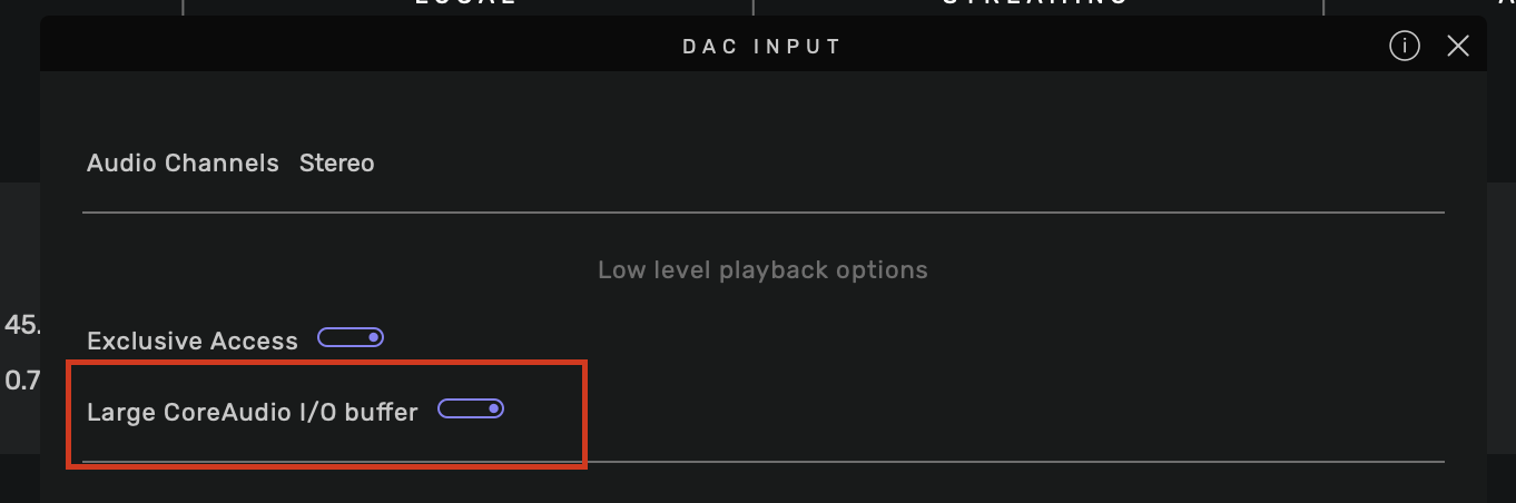

A couple of things to adjust… however, you must ask why the N8ii (from the same company as RU6) is giving you problems… If the N8ii is playing fast, this is a synchronization issue at the DAC…
  • Lower the audio buffer pre-load RAM to 6GB… you are using more than 50% of your system RAM for pre-load buffering.
  • Set ‘Use max I/O buffer size:’ ON
Thanks for the feedback!
I modified the buffer size but I can’t find this option in the menu:
Also it looks that this is track related.
I found at least one album that can be played well.
No idea how different it is from others.
Also make sure Audio MIDI Setup is configured for the maximum sample-rate of the DAC (768kHz).
Thanks @Agoldnear, I understand that the entry name was updated.
So I spent some time playing with every parameters but none is effective aleas.
I activated the option ‘mute while rate change’ and this time I do not ear another track
but it is silenced. Looks like a deep bug in the engine that jumped from one buffer to another.
