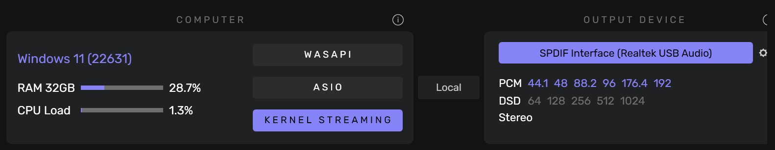

When I switch to Kernel Streaming I do not get any sound. Track begins to play, everything ā€˜looks’ fine but no audio.

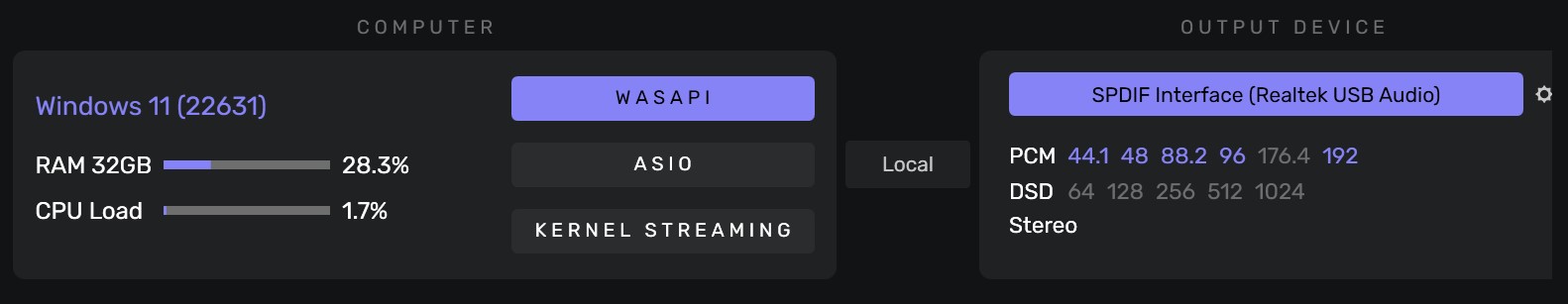

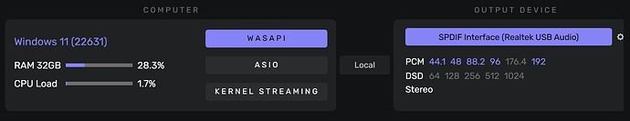

I am running Windows 11 and my mobo has TOSLINK out connected to a Genelec F2. Here’s what I see under WASAPI (note that Genelec DAC does not support 176.4 kHz) …
And here is what I see under Kernel Streaming (note that 176.4 kHz is now ā€˜active’. which strikes me as a bad omen) …

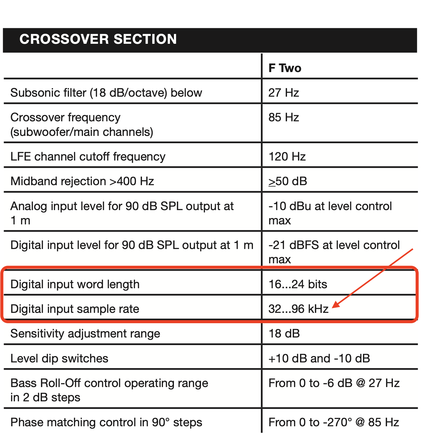

Genelec shows the F Two having a maximum supported digital input sample-rate of 24/96kHz…
From the Operating Manual:
Numerical typo on my behalf, @Agoldnear, the DAC in the F2 does cap out at 96 kHz. I have the ā€œmaximum sample rateā€ set accordingly in addition to the ā€œbitdepth maximum of 24 bitsā€.
The advantage of using an outboard DAC is that you can utilize the analog outputs to playback much higher resolution digital-audio files through the analog inputs of the F Two sub… There would be no playback restriction outside of the maximum sample-rates supported by the DAC.
